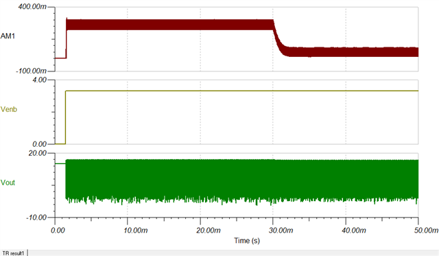

The Tina DRV110 simulation example doesn't seem to work properly and immidiately goes to pwm and not peak current so waveform is not as the datasheet would imply.

The SBWM004A.TSC works as expected.
Please increase simulation time in transient analysis and separate curves from View menu. Please let me know if you have any questions.
