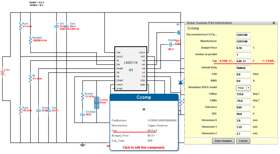

    [Q3]
    We would like to know the phase margin at the Case1 which is based on the parameter of the case2.
    Therefore, We created a new design to set the Vout=8.0V(Case1).
    However, I can't input the value which is based on the case2 to the Ccomp,Ccomp2,Rcomp,etc.
    Because there is the limit of the value.
    Could you please improve this phenomenon?
    I’d greatly appreciate your verification.
    <For example>
    We would like to input the Ccomp=560pF(This is a recommended value of case 2).
    However, we can’t input this value, because the range of the Ccomp is 620pF to 760pF.
    Kanemaru
  • Hi Kanemaru-san,
    You can still enter values for custom components that are outside the lower and upper limits. Click the "Save changes" and when the warning message comes up, click Ok.

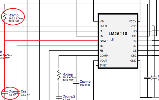

    How do you decide a value of the Rramp?
    The calculation method of the Rramp is not mentioned in a datasheet.
    So, if we use same value at the case1 and the case2, we would like to know about your choice.

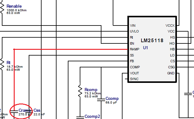

    <Case1>
    -Rramp is not connect.
    -Cramp is 270pF
    <Case2>
    -Rramp is 280kΩ
    -Cramp is 1.5nF
    Kanemaru
  • Hi Kanemaru-san,
    The BOM calculator adds the Rramp resistor on the condition when the Vout is greater than 14, VinMin is greater than 7 and the estimated duty cycle for buck and boost mode are both greater than 45%.
    Rramp is calculated as Rramp = Vcc /(Vout * gm - Ioffset), where Vcc=7, gm=5e-6, Ioffset=50e-6
    This Rramp value is one of the parameters used to calculate the compensation components for the circuit. If no external Rramp component is used, then the calculator uses the value of 10e6 instead.

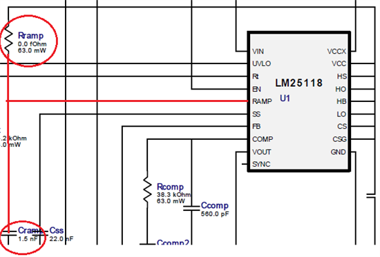

  • Hi Kevin-san,
    Thank you for the information.
    According to your advice, I believe that the Rcomp is not necessary if a phase margin is ensured.
    Therefore, I performed the simulation that I change the Rcomp =280kohm to 0ohm at the case2.
    <Case2 simulation>
    The phase margin is 36.15 deg.
    In addition, I changed the Cramp= 270pF to 1.5nF at the case1.
    So, I believe that I change the Cramp if a phase margin is ensured.
    <Case1 simulation>
    The phase margin is 46.455 deg.
    Is my understanding correct?
    Kanemaru
  • Hi Kanemaru-san,
    I agree with your verification and think the analysis is good. The next best step is to create the design on a PCB and test the performance to ensure design accuracy.
