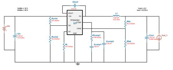

Using a 10 to 50V input range with 0.016mA output and 4V with the TPS54062 use to give the following result:
with a 1mH inductor. it now gives:
with a 3.3mH.
I was wondering if someone could help by explaining why there is a difference, and which one is better.
Thanks for the help
Philip
Philip,
I am not sure why you see a 1mH in your older design. The inductor selection has not changed and the 3.3mH inductor is the correct one. If you point me to the date of creation, I could look into this.
The difference of having a 1mH will be an increase the inductor ripple to about 80% of Iout as compared to 30% of Iout with the 3.3mH.
Please let us know if you have any more questions.
Amod Vaze
