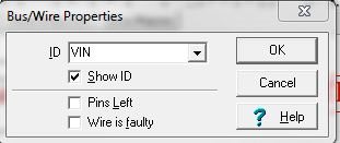

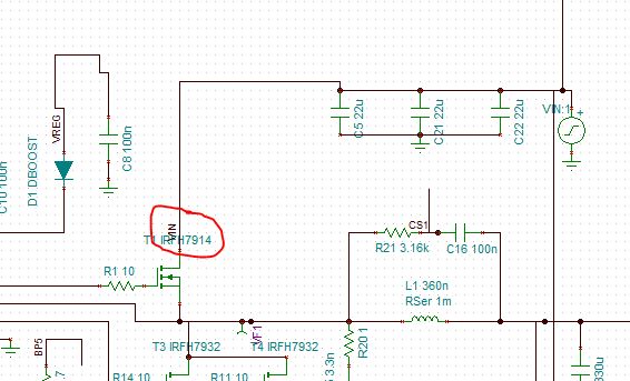

    I have found a couple of issues with the schematic. First is the Vin source:
    What kind of VIN waveform are you trying to achieve? Normally, I would use a PWL to 12V with  a fixed startup time and then a constant 12V. When I change this source, the simulation still does not converge, but when I add the VIN ID to the VIN wire so that all VIN labeled wires are now connected to VIN:
    The simulation converges and finishes, but does not give the results you are looking for.

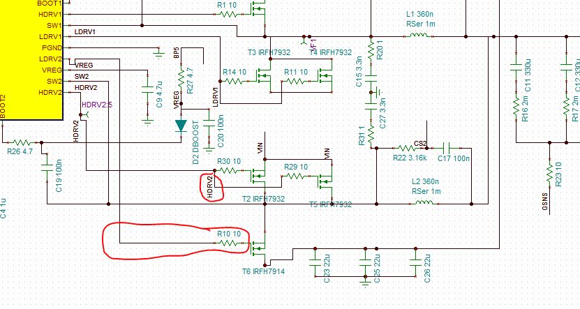

    Apparently, you have switched the LDRV2 and HDRV2 connections and tied the VIN improperly to the lower half of the schematic. Based on the schematic picture you posted, HDRV2 and LDRV2 are not connected properly.
    I believe that once you fix those connections, your simulation should run properly. Please make sure to add the VIN id to the wire connected to the VIN source or you will not have VIN at all of the connections.

    Adding the ID 'VIN' did resolve the issue. I was of the opinion that since the source is named VIN, any wire with ID VIN will be connected to it. But it wasn't.
    Now after giving the ID VIN to the wire connected to source, it did work.
    And regarding the VIN source, I was just trying the square wave with very large time period, which is same as 12V source till the time period and with some rise time.
    And HDRV2 and LDVR2 interchanged, was during the process of schematic changes, we had attached the old .TSC file. We did change that before.
