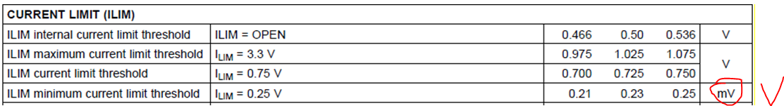

I've been debugging my spice model for a few days and it seems to me like the UCD7100 model may be faulty. I incorporated it into ltspice and it does trip have the ability to trip when CS is in range of ILIM but not at all in the range that the datasheet says and this is very troubling for my design.
The datasheet says the output is forced low when the CS pin exceeds (ILIM - 25mV) :(see here: )
although when i ran the simulation in which i set Ilim to 0.9 volts and slowly increased the CS pin from 0 to 1 Volt i realized it trips at a completely different time.

    I, too, have confirmed this value. I get the 717mV as well. I am investigating an equation in the model that sets the ILIM threshold internally and does not use the actual value of the ILIM voltage. The equation is in the unencrypted model:
    E_ABM5         ILIM_DIGITAL 0 VALUE { IF(V(ILIM)<0.75,{1.4495*V(ILIM)-0.3622}, {0.1176*V(ILIM)+0.6368})    }
    In your example, ILIM is set to 0.9, so the second equation is evaluated and gives 0.742. The 25mv is subtracted from that in another portion of the circuit, which gives you the 0.717 value.
    I believe that this has something to do with the differing thresholds of ILIM based on the voltage values provided in the datasheet table 7.5. However, I have not yet confirmed this yet. The value is also limited between 0.23V and 1.025V.

    Unfortunately, there was more wrong than just a simple fix to the model. The datasheet has an error in it and this caused the way the model was implemented to behave incorrectly. I had to verify that the datasheet was incorrect and what the proper implementation of the fix should be. We have identified it and it will be submitted for update shortly. I do not have an estimate of when the model update will be completed.
    I do appreciate the report of the issue. In this case, it was not a simple task to find the root cause.
    I will post a follow-up when I have more information about the update and the timeframe for it.
  • Thanks for the effort Britt, Could you please elaborate on what is wrong with the datasheet? What needs to change in the datasheet?
    The follow-up will be much appreciated!
    Thanks again for all the help
  • Ian,
    Specifically:
    So, the behavior of ILIM should be:
    ILIM > 1.025, ILIM = 1.025V
    0.25V <= ILIM <= 1.025, ILIM = ILIM
    ILIM < 0.25V, ILIM=0.23V
    IF the CS level exceeds ILIM, then driver is pulled low AND CLF is set high until the next rising edge of IN.
    The model will be updated to reflect this behavior. There are currently fitting equations to bridge between values and ranges because of the way that the information is specified in the datasheet.
