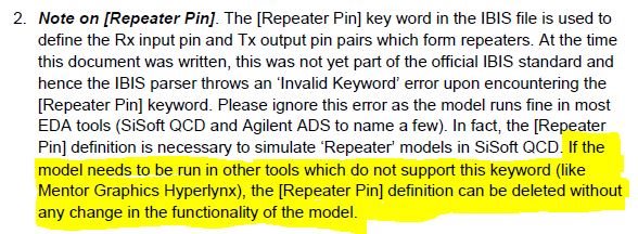

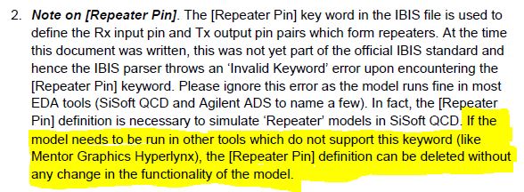

  • checking through the user guide accompanying this model, I came across a note regarding this line of code in the model in page 9 of the doc. A snippet of the note is shown here and the document is attached for convenience. it basically calls for removing [Repeater Pin] keyword from the model file. first I removed only line 149 by commenting it out. But trying to use the model again I got the same error message only this time pointing to the next line in the model file. then I decided to comment out the whole section under this key word and tried using the model. This time it errored out but pointing to lines 228, 256, & the last line of the code "End" in line 8813.

  • Hi Ali,
    I see the problem now.
    In Model RX_IN, on line 192 and 193, vinh and vinl are specified, but the values are backwards. vinh=0.45 and vinl=0.55.
    If you swap those, that should fix the error.
    And you were right to comment out the entire section of Repeater Pin as the values after it would be unreferenced and would result in an error.
    David
  • Thanks Dave.
    Commenting out [Repeater_Pin] definition (lines 149-158) and swapping the values of Vinh & Vinl (lines 192 & 193) resolved the issue.
