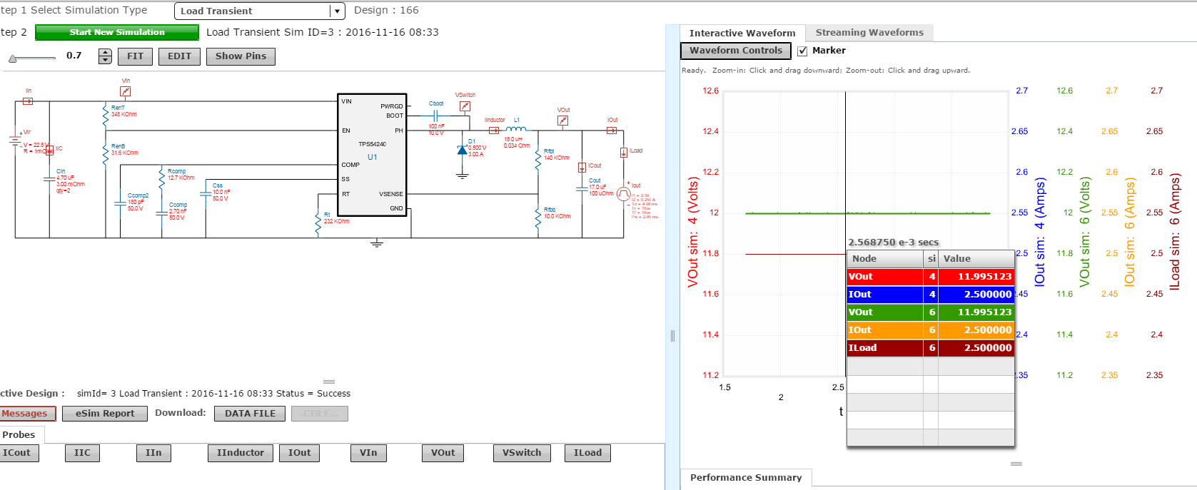

The phase/gain margin appear to be correct, however the SIMs don't appear to run. See the screenshot below--the load transient simulation doesn't change in current:
Is this a bug with the TPS54240 model? Or is WEBENCH only able to simulate 'recommended' designs?

We identified the issue and it was fixed last night. Please give it a try again. For your convenience, here is the working design and simulations with your inputs:
https://webench.ti.com/appinfo/webench/scripts/SDP.cgi?ID=B4251A8D5FA5AB60
Hi Nikhil,
I saw the same problem on Friday (18th) however the simulations worked today without issue.
