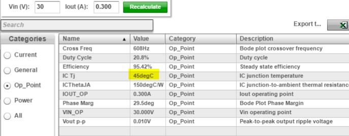

    The issue is when Vin = 30V, Vout = 36V (and Iout = 300mA), I have the following message:

    I don't think this is the issue here, since the higher the input voltage goes, the lower the IC dissipation is (as it's a boot, Duty Cycle is lowering ans Vin goes up, and since the LM5000 is an async converter, the internal FET as less to dissipate: both less time and less current).
    Please have a look at bellow extract from your test, where I modified the operating point to 30V, and where we can see the IC temperature raise is pretty limited:

    I agree that at higher Vins, the IC should be cooler.  But, there is a dynamically temperature loop in the CC looks at the full Vin range and it failed the temperature check.
    As you can see below, the OpVal shows 124 deg C with Ta=25 Deg. C which just met the cutoff line of 125 Deg. C.  Using default Ta=30 Deg. C,  the design fails to create with a given conservative Theta JA value of 150 Deg.C/W.
    So, I don't see this as an issue with WEBENCH but it's a conservative design tool which it has the flexibility to create the designs with forced input conditions.
