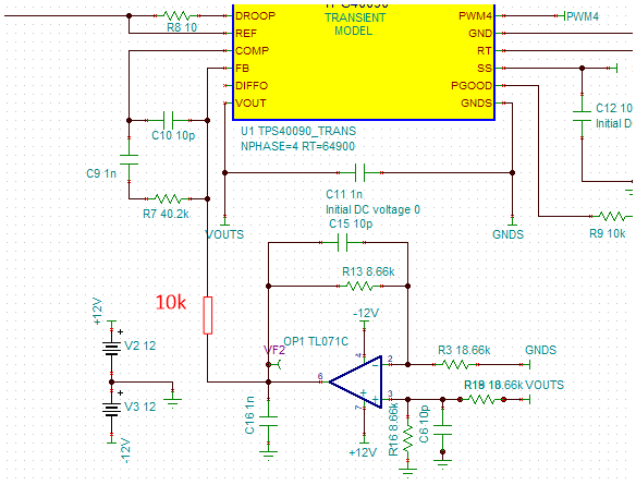

    I'm designing a buck converter using TPS40090 as the controller. This buck converter need to be a programmable one which means that i can control the output voltage based on the program voltage. This IC has a internal 0.7 voltage reference which can be disconnected. This is where i can connect my program voltage value.
    TPS40090 has internal error amplifier. My objective is to convert this internal error amp as a buffer (to bypass the internal error amp) and using external error amp with compensation.
    The reason why i want to use external error amp is because i have 3 control mode which is constant voltage, constant current and constant power which has its own compensation value. so i need to have 3 external error amp instead of one and feed it back to the internal buffer (which is the internal error amp converted to buffer) .
    I have tried doing this but the whole simulation is not working. I believe there is influence from SS pin and Idroop pin which in the diagram are also connected to the internal error amp, therefore the internal amp cannot be converted into pure buffer.
    Appreciate if you guys able to give some ideas regarding this issues.

    In your circuit, the loop will make COMP/FB voltage be equal to DROOP pin, it is not able to regulate Vout to external Vref.
    I think the output of external error amp should be connected to COMP pin directly.

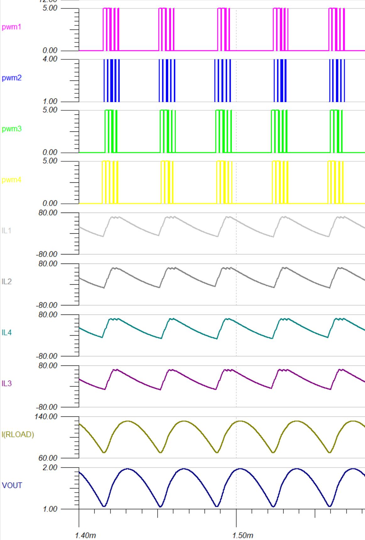

    I have made the changes like what you have suggested. The pwm signal turn into discontinuous mode and the output voltage fluctuating.
    What i did is i connect the output of the external error amp directly to the COMP pin while maintaining the original connection to DROOP, SS and REF pin.
    I wonder is there any influence from DROOP and SS pin to the internal error amp causing the circuit to behave like this. Can i get a more detail schematic of the internal error amp to have better understanding on the
    expected behaviour?. Below is the waveform and the circuit
  • Hi MUHAMMAD,
    The droop voltage is the reference voltage of internal error amplifier. Since the internal error amplifier is bypassed, the droop voltage should not be related to the issue.
    I guess the loop is not stable. For debugging purpose. can you just apply a voltage source on COMP pin and check if Vout is stable?
    If Vout is stable, the issue should be related to external circuit.
