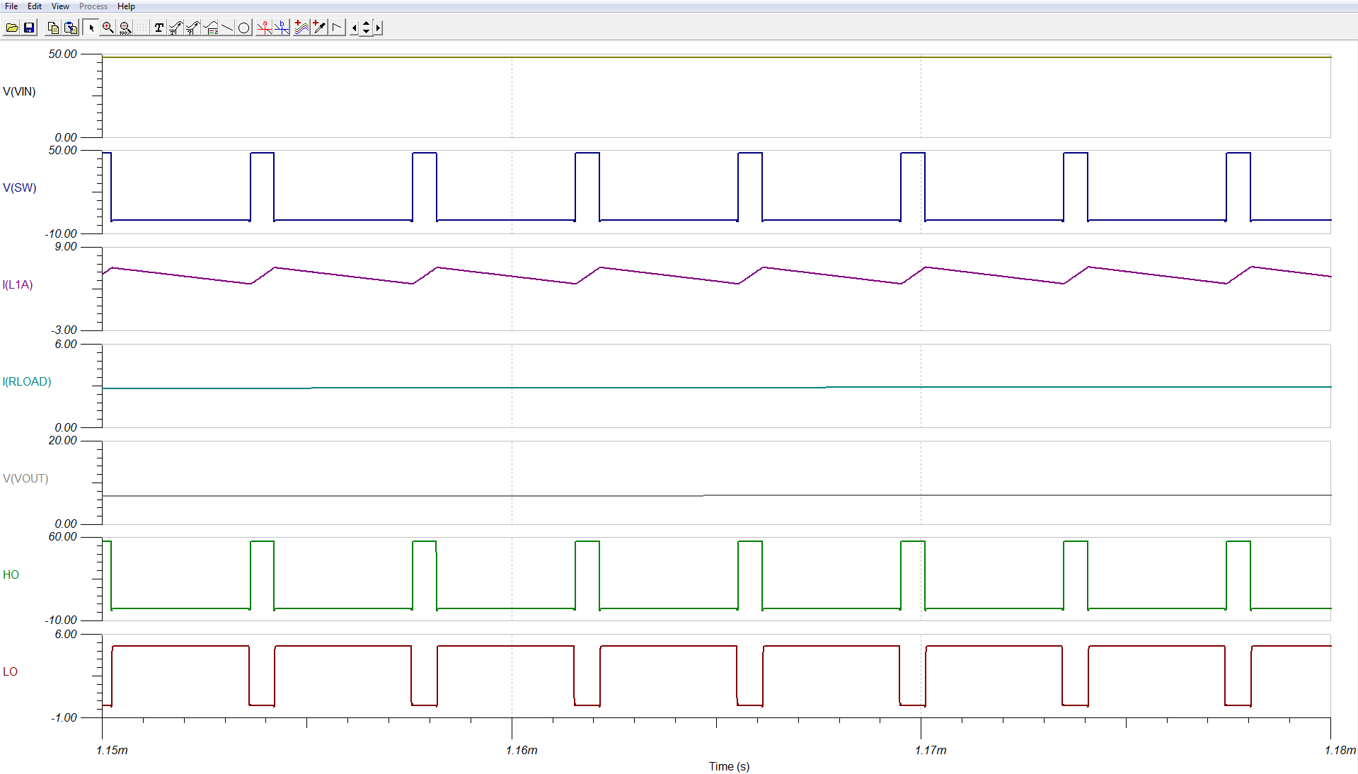

  • Andrew,
    Making a model work in a simulator has 2 aspects
    (1) Making the netlist compatible with the simulator (looks like you are already over this hurdle)
    (2) Making the model converge with the simulator
    Both these steps require the model and the simulator to work closely and many times also required the simulator to adopt algorithms to support the model constructs. While many simulators claim to be PSpice compatible, that is a very generic statement in many cases and issues are typically found when PSpice models are imported as in this case.
    We have worked very closely with the developers of TINA-TI to make sure that PSpice models are truly compatible with their simulator and provide a seamless experience to customers like you when simulating with TI parts. We already have a TINA-TI model available for this device: .
    From the issues that you have described above, it could very well be that your simulator is not able to handle the constructs in the model appropriately. By using TINA-TI, we can eliminate that guess work.As you can see, I do not see any high frequency ringing in the LO pin. I hope you can give it a try. A typical application is already setup for your convenience.
    Also if you are new to TINA-TI, we have a short Video Training Series which will help you get ramped up quickly on this. Please see the link below.
  • First line of my post: "(Please do not tell me to use WebBench, TINA Spice, etc.)"
    I would like someone to try to address my questions.  The reasons for using an industry-standard Spice simulator like LTSpice, instead of a TI-specific simulator like TINA-TI, are not in my control.
