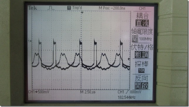

  • Hi Sonal,

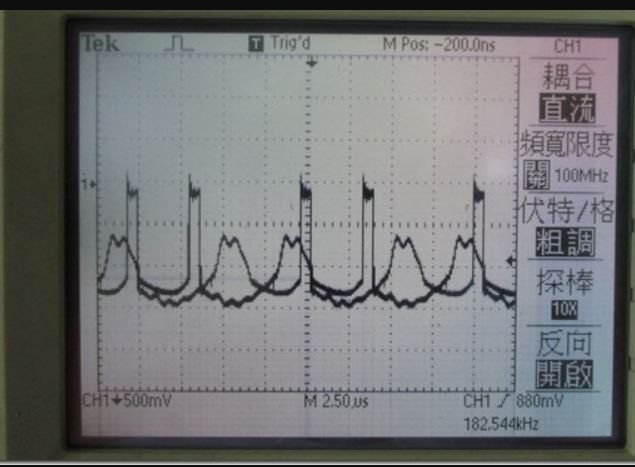

    We had done the PCB and had build the transformer base on above discussion. The turn ratio of our transformer is Primary : 2nd : Aux = 4:26: 4 which is the same as your suggestion. The choose inductance we are using now is 45 uH.
    Some question would like have your input.
    Question 1:
    Test condition: Input 10VDC,  output 24.4V 0.2A. Q1 waveform as below (refer to PMP7294 schematics).
    - At this condition the circuit seems works fine. But when we increase the output current the circuit shot down.
    - Also if we keep the output current at 0.2A and increase the input voltage the 12VDC the curcuit also shut down.
    Do you think below waveform looks OK ? (the ON duty looks > 70%)

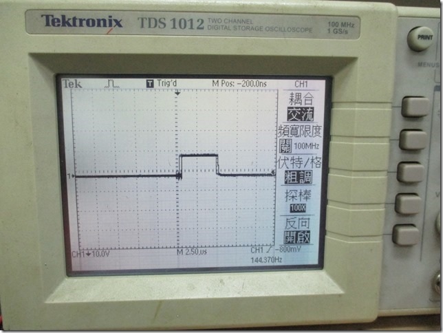

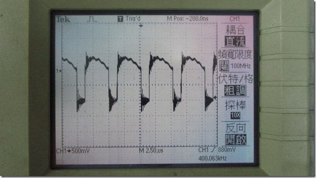

    Test condition: input 10VDC, oout put 24.4V 0A. The circuit works fine. The we keep the output current at 0 A and then change the input voltage from 10V to 16V. The cirtut still works fine.  Q1 waveform (refer to PMP7294 schematics). is below Waveform looks OK?

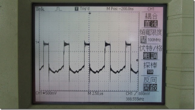

    Test condition: input 10 VDC, output 24.4 V/0.2A. We measure AUX (D202) waveform (refer to PMP7294 schematics) shown below. Is there any requirement for AUX voltage level? We would like to know if below AUX waveform looks good.

  • Hello PY Tsai,
    Please explain what do you mean by shut down? Also, I would like you to check if UCC2897A is hitting any Overcurrent or Overvoltage limit which leads the controller to stop working. Checking voltages at LINEUV, LINEOV, CS and Vref will be a good starting point.
    To answer your Question4 and 5: RON value determines the internal charging capacitor's charging current. and this with ROFF determines the operating frequency and the Maximum duty cycle(operating). Section 8.3.1.3 od the datasheet will help you calculate these values for your design. If you want the switching frequency to be 175kHz you will have to calculate RON and ROFF for your design.

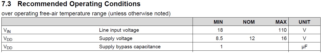

    1. We found this probably the the cause. UCC2897A Vin requirement is 18V as shown below. My Vin is now 10V, do you think will it work? or i should do a voltage doubler to double it to > 18V then feed into the Vin pin of UCC2897A (like the implementation on our reference design PMP10861)?
    2. VDD 10V looks ok, is it ? thanks!
  • Hello PYTsai,
    1. It is very important to follow the recommended values on the datasheet. I strongly suggest that you should provide a Vin to the controller of 18V or above. A voltage doubler is a good option to continue with.
    2. A 10V VDD looks good.

    4. I noticed from your previous question2 (attached image) the switching frequency looks overlapped over time, please adjust your trigger level in order to capture better waveform.
    5.In reply to question3 D202 is not the AUX voltage. AUX voltage is VGS of Q2 from the PMP7294 schematic. This function drives the aux-clamp of the             MOSFET when the PWM switching is OFF the MOSFET is HIGH. It is a high-current gate-drive output for the auxiliary switch to implement the active-        clamp operation for the power stage.

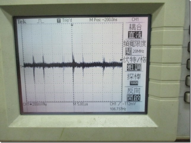

    Now we fixed the turn ration 1:3.3:1. When shut down happen, we measure below value and also the CS and AUX waveform. Any more information we need to check ?  thanks!

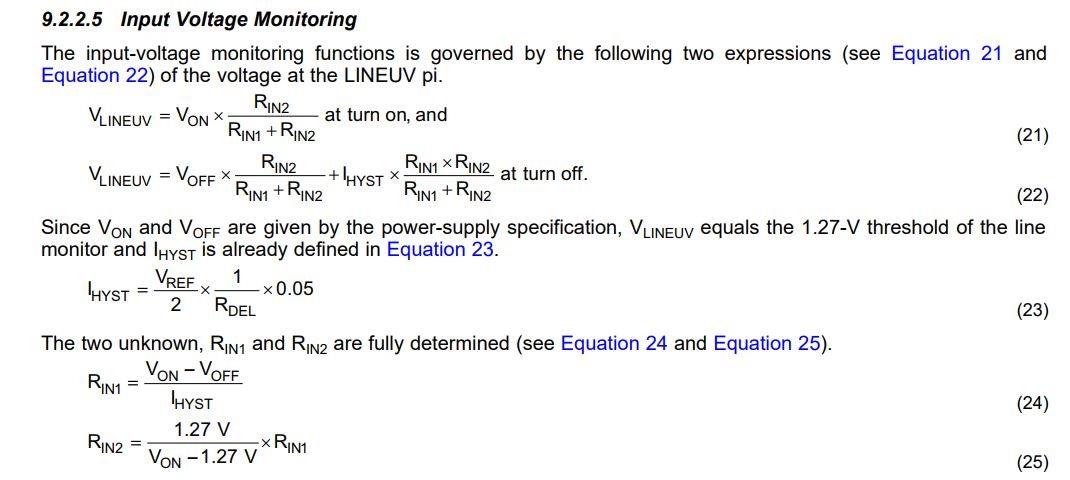

      Line UV = 1.8V
      Line OV = 0.38V
      FB = 5.0V
      VDD = 12.2V
    CS Pin waveform
    AUX waveform
  • Hello PYT Sai,
    I can clearly point out two problems with the data above:
    1. Your LINEUV is 1.8V however, the max LINEUV is only 1.27V as per UCC2897A datasheet. I would suggest redoing the calculations for resistor RIN2, RIN1 on page 31 under section 9.2.2.5
    2. Also, just to point out the FB voltage of 4.5V results in full-duty-cycle (Dmax=74%) operation. I would like to draw your attention to section 8.3.1.9:FB.
    I hope this will help. Let me know if you have further questions.
    Sonal
