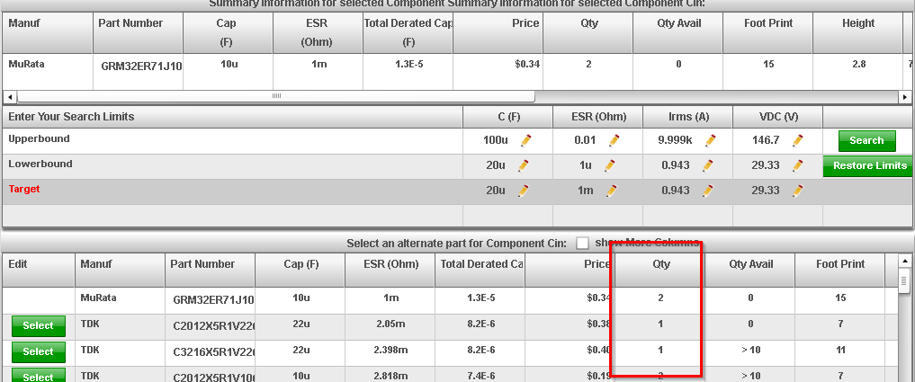

How do I change the QUANTITY of input or output capacitors in WEBENCH??

The question is about changing the QUANTITY of capacitors, and I've found no way to do so in WEBENCH.  Any suggestions??
  • Hi Grayson,
     We cannot directly change the quantity of capacitors. However we have the quantity column on alternate page and see if any caps meet the requirement.
    You can also change the lowerbound/target/upperbound cap values and see whether the combinations can meet the requirement.
