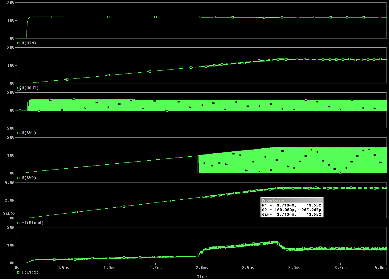

  • Hi XinYuan Huang,
    I tried to setup the Pspice released model with this schematic and found that it was able to regulate. Please find Pspice schematic and results below for your reference.
    Please note that the feedback resistor network used in you schematic sets VOUT at 13.5V and not 15V.
    Kindly revert in case of any further query.
