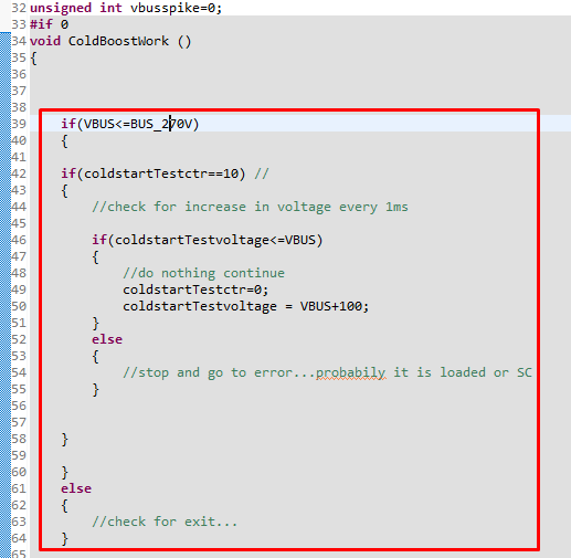

And now, we have another question about COLD START mode. We have a version of your code that it seems not completed because some of the instructions related with that mode are Commented:
- Since your PDF TIDA-00951 has results scopes from the COLD-MODE, but your code version given to us appears as in the above pictures...it seems that our version is not the right one, please, have a look to this failure and give us a solution for running up the prototype in our LAB.
Please, help us with these problems, we need the correct software code if our version is not up to date.

Hi Guillermo,
This part of the code is intentionally commented so that it does not get accidentally triggered during initial testing when load is connected to the 400V Bus.
The cold boost is intended for working only under no load condition on the 400V Bus at startup. You can enable the functionality by simply un-commenting the code.
Ram
