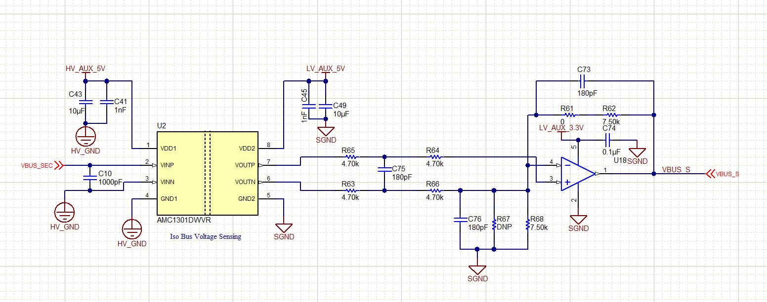

    We are having problems with the reading of the ADC channel whta comes from the VBUS voltage level. And we have found two different versions of the accomodation signal circuit from VBUS point to the ADC B6 channel. The question is, what is the correct between these two schematics?
    1) Circuit shown on the PDF of the TIDA-00951 section 6.3.1.7 Isolated Voltage Sensing: http://www.ti.com/lit/ug/tidud04/tidud04.pdf
    2) Circuit shown on the SCHEMATIC of the TIDA-00951 Sheet 3, and for that, the final ALTIUM project and physical PCB: http://www.ti.com/lit/df/tidrr65/tidrr65.pdf
    We are reading always in Code Composer the same value in bits (Saturation): 4095 no matters the voltage in the pin VBUS of the power circuit, so please. Let us know what circuit of the shown above is the correct.
    Have a nice day,
    Guillermo Perez
  • Good morning TI,
    Regarding the last issue about the VBUs signal conditioning with the AMC1301 and the OPA276 circuit, both versions (TIDA-00951 and Altium files from your product website) are wrong.
    We have simulated both versions of the circuit in LTSpice and none of them works as espected, so we have searching on different application notes related to the AMC1301 and OPA376 as an isolated signal conditioning and we have found the right configuration, which works fine in LTSpice. This circuit is shown below:
    - We have simulated with good results this circuit so, the question is, What do you think about this? What is the solution?
    Guillermo Perez

  • Dear Ram,
    The circuit you proposed for the VBUS sensing saturates its output too early, I  have simulated your proposal. See the attached picture:
    We have implemented this circuit and it shows better response both in simulation and in real Hardware testing:
    What do you think?
    Thank you
  • Hi Guillermo,
    The R7 and C3 need to connected to the +ve input terminal of the opamp in the first simulation that you showed.
    Adding a 1.2V offset in the 2nd simualtion is not a problem as such. It will result in an ADC ofset of +1.2V at 0 input voltage on the BUS.
    In the cirucit 1 simulated with the changes I suggested in this post, you should be able to elimiante the offset. The TIDA-00951 firmware will expect close to 0V offset at 0V Bus input, unless you change it accept a 1.2V offset.
