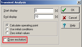

How can I set such that the TINA do not plot all the power supply ?
  • Hi Sunil,
    When you run the transient analysis, kindly make sure that Draw excitation is unchecked. Then all power sources will not be plotted.
