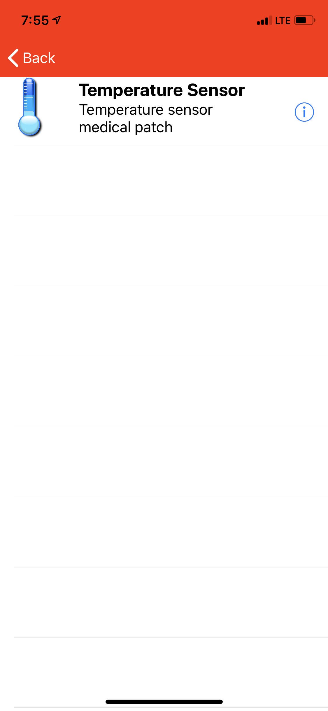

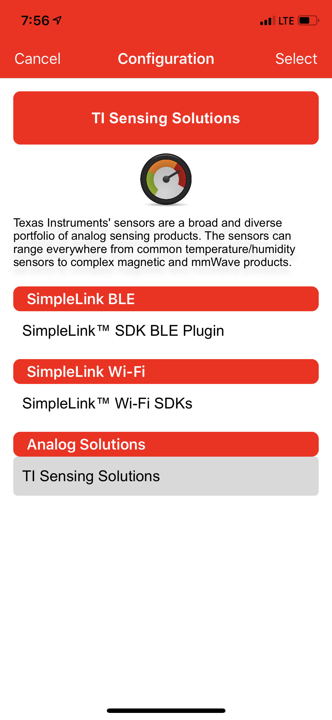

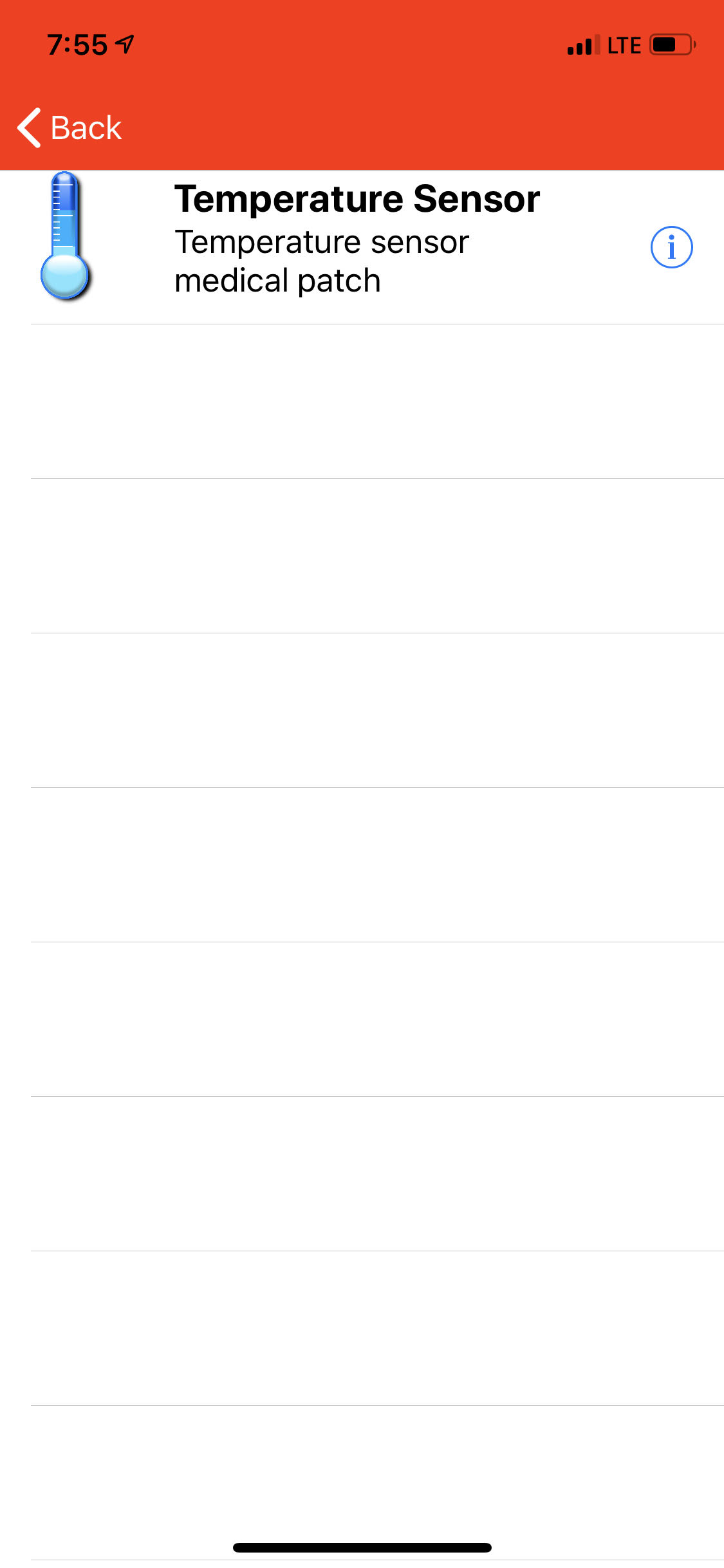

  • Hi Josh,
    Thanks for your reply. I don't think the version of the provided SDK is compatible with TID-01624. I'm guessing there's a modified version of the SDK where the analog solution is added under the app configurations to accommodate for the sensor measurements.
    If you can guide me to where I can find the appropriate SDK to the medical patch sensor that will be super.
