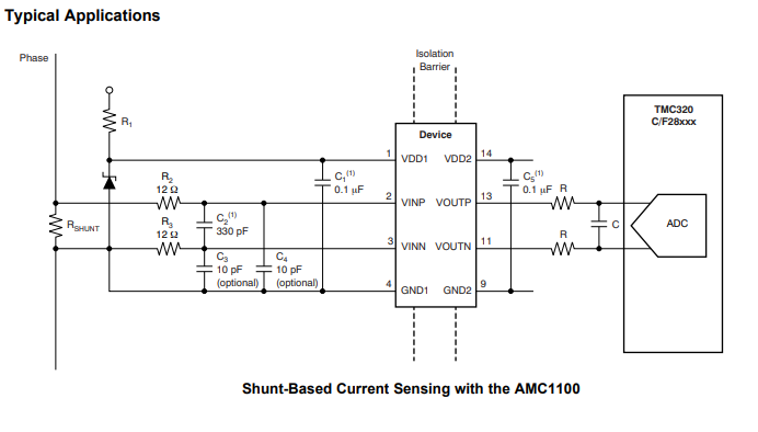

I see the isolated power supply provides two outputs in this design: -6V_WSH and +5V_WSH, which are regulated to -5.0V_WSH, and +5.0V_WSH. The positive +5.0V_WSH is used to supply the AMC1100. But the only application of -5.0V_WSH is to limit the inputs of the AMC1100 between -5 to 5 by using DESD1P0RFW-7. Is this a true statement?
If yes, if we do not want to protect the AMC1100 in this way, then we should be able to use a cheaper design and only use one positive value (+5.0V_WSH) for the isolated power supply. Is the second statement true?

  • The main reason of my question is the application note of the AMC1100. In this document there is a typical application guide, which does not use the DESD1P0RFW-7 for the VINP and VINN.
    Correct.
    Yes.   Just to add, the protection approach depends on the application and performance requirements.

  • Thank you for bringing up AMC1301 as well. The product we are currently working on is a grid connected rectifier. We are investigating different ICs and design, to find the best solution for our application. We already tested AMC1301, for AC and AMC1311 DC measurements. Now we want to test AMC1100.
    As you can see in the above picture, right after the AMC1301, the designer used a pull-up OPAMP (OPA2188AID) to range the output between 0 and 3.3V for the microcontroller. But here in TIDA-00555 there is no pull-up OPAMPs used to range the output of the AMC1100 to the 0-3.3 V for the micro controller. Could you please explain the reasoning behind it?

    The signal scaling depends on the ADC being interfaced to.
    The isolation amplifiers provide a differential output and in TIDA-00555, The output is interfaced to ADS131E08, delta-sigma ADC with differential input.
    In short, if you have a ADC with differential input up to +/- 2.5V, you can directly interface the isolation amplifier output.
