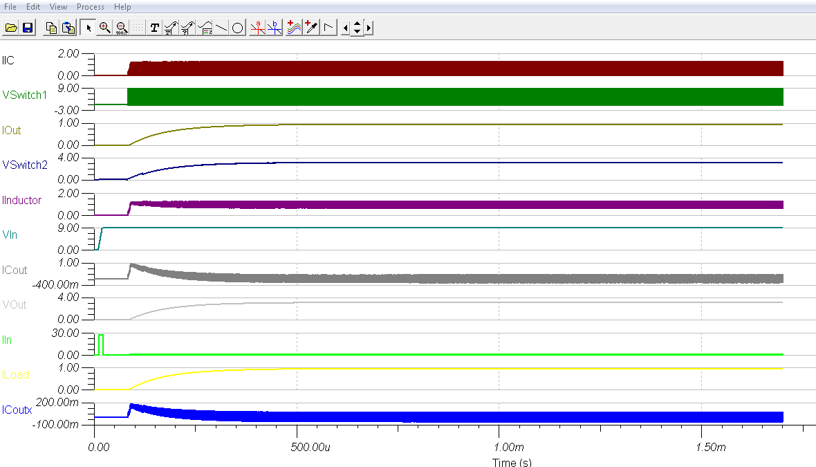

    Please find TINA simulation result below,
