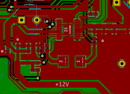

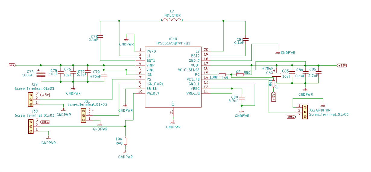

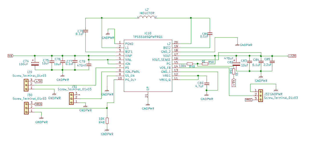

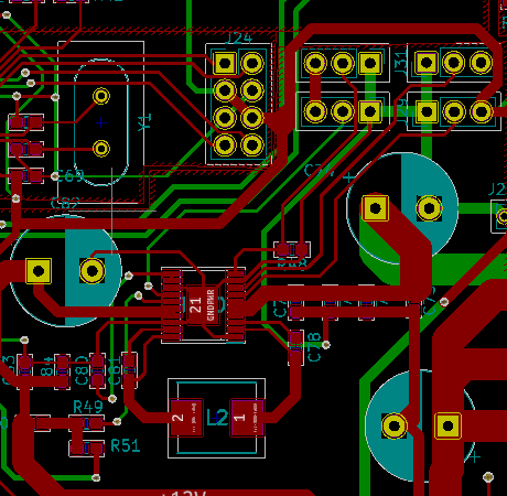

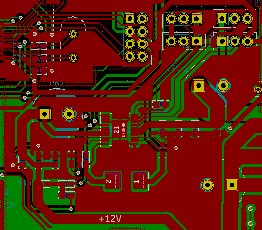

Hi guys,
this is my schematic for 12V configuration ,
SS_EN           - gnd
IGN_PWR      - VREG
PS                  - gnd
PG_DLY        - gnd
FB                  - gnd
PG                 - VOUT or 5V
connecting this pin in this configuration working fine.At the time output voltage 5V
but I need 12V ,600mA I change the configuration as per the webbench design tool like wise
SS_EN            - gnd
IGN_PWR       - gnd
PS                   - gnd
PG_DLY          - gnd
FB                   - gnd
PG                  - VOUT series with 100k
In this configuration IC can't power up that means did not wake up .Please help me to fix the problem
