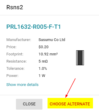

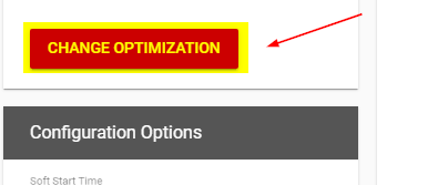

    1. To answer your primary question, yes Webench uses set of criterion such as cost and footprint to name a couple of them. We can always select the low cost or low footprint design from optimization option in Webench too.
    Another way to select the different resistor would be through alternate parts selection where we can sort the available resistors for power rating , price, footprint  etc.
    2. Webench has a limited database as well. Currently it would be difficult to tell, the selected part is due to unavailability of optimum part. I will forward this as feedback to development team to consider for its future road map. But you can always select alternate parts for the components.

  • Thanks for your response.  It sounds as if you are saying this data is not available.   I am aware of the "Choose Alternate" feature, which is useful - if there is an alternate. But it would much more useful to have the parameters that I could use to choose my own part.
    The Power Designer MUST have this information in order to choose an acceptable part - it would be a very valuable feature to supply this data to the user.
    This data is even more important when no part suggestion is available.
