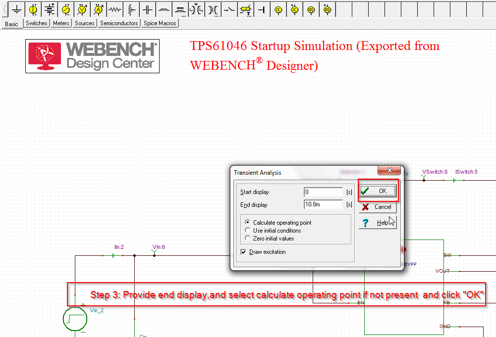

I was able to specify a design in Web Bench for the TPS61046 and export it to simulate further in Tina. Tina shows the subcircuit for the 61046. Sim doesn't work however - output never gets to specified voltage using the circuit that Web Bench built.
I also notice that TPS61046 is not in Tina library. I have it in my design from the Web Bench export, but I could never add it to a new design.

Hi Joe,
I exported TINA-TI design for WEBENCH default condition [TPS61046 - Vin=1.8-4.5V, Vout=12V, Iout=0.05A]. The simulation ran fine. Please find below snapshot of the results FYR.
Regarding your query on TPS61046 not present in Tina library,
You can directly copy (Ctrl + C) macro from WEBENCH exported .TSC file and paste (Ctrl + V) it in the new schematic. Kindly let us know in case you have any further queries.

I tried exactly what you suggested. The exported design from Web Bench did not run in the simulator. I don't know why it worked for you.
My second question was why the TPS61046 was missing from the library. You are correct in that if I *already* have a design with that part in it I can copy it out to another design. But it appears I can't add it to a new design without constructing an example design first? Is that the only way to access certain device models?
Hi Joe,
Please find exported TINA-TI design below for your reference.
/cfs-file/__key/communityserver-discussions-components-files/234/webench_5F00_design_5F00_5197183_5F00_6307.tsc
Please find the steps below to simulate the exported TINA-TI design
Regarding your query on accessing models in TINA,
Yes,constructing an example design first is the only way to access device models.
