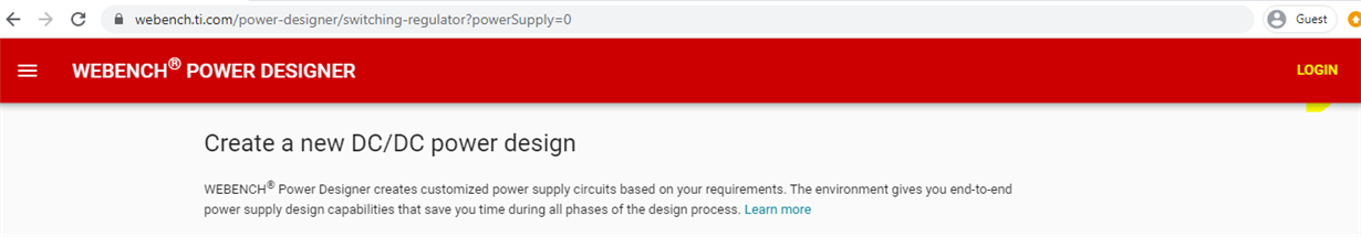

  • /power-designer/switching-regulator
    When I enter the TPS40210 the app gives me the list of parts it has found. I'm selecting "TPS40210 Boost" and the Web App fills in the input parameters. It fills them in wrong, (Vin Min 8V Vin Max 14V). That input section is then greyed out so that I can't change any of the input parameters. I think the Vin Max of the TPS40210 is a bit higher then 14V DC.

    The WEBENCH fills the default inputs /output values automatically once you select the device in the search bar. However, you can change these values within a given range as per your requirement. Please click on View Design to create the WEBENCH design as shown below.
    Please ensure the following points to avoid grayed out area.
    1. Make sure the input and output values entered in the field are within the given range.
    2. Please make sure you have logged in.
    3. Please read and agree with T&C Checkbox.
    Please note that  TPS40210 WEBENCH design is not getting creating for VInMin=9V, VinMax=12V, Iout=1A and Vout greater than 74V because the WEBENCH is not able to find a suitable MOSFET from the database for the above conditions. Please reduce the load current or output voltage to create the design.
