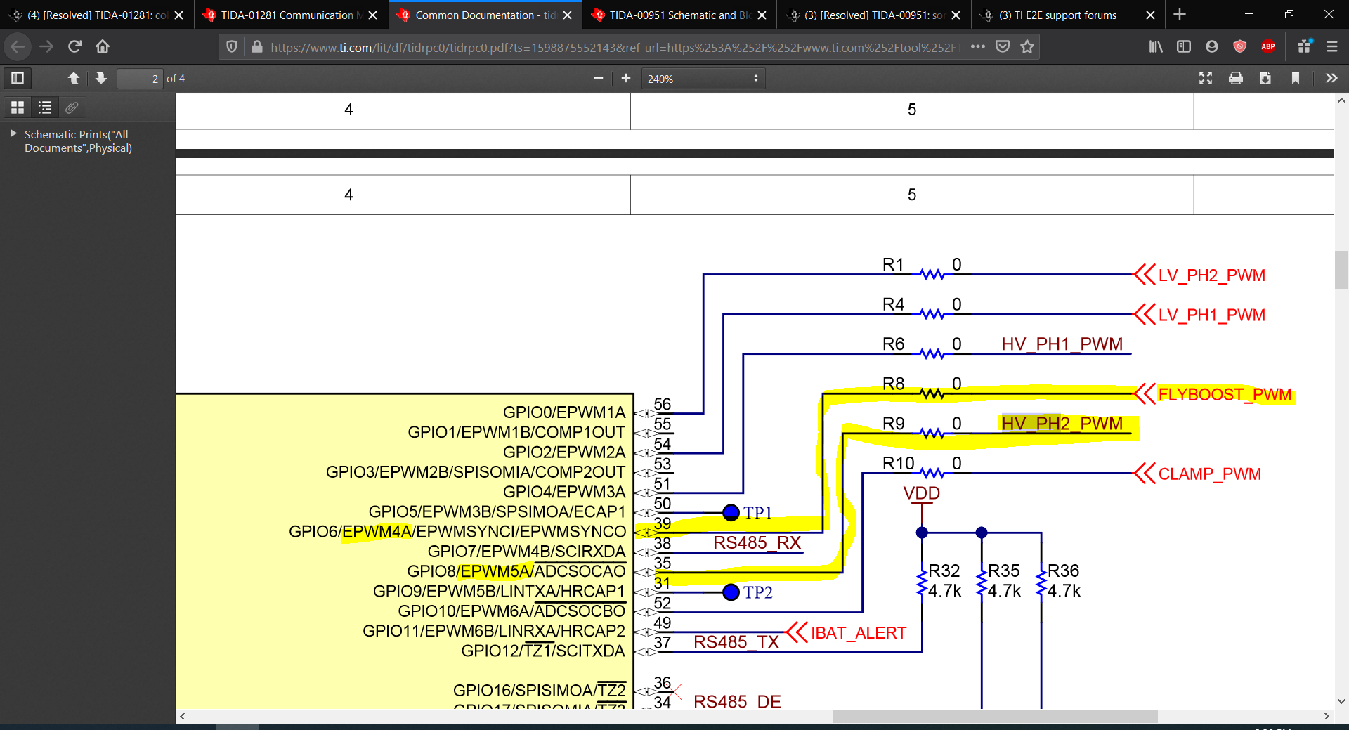

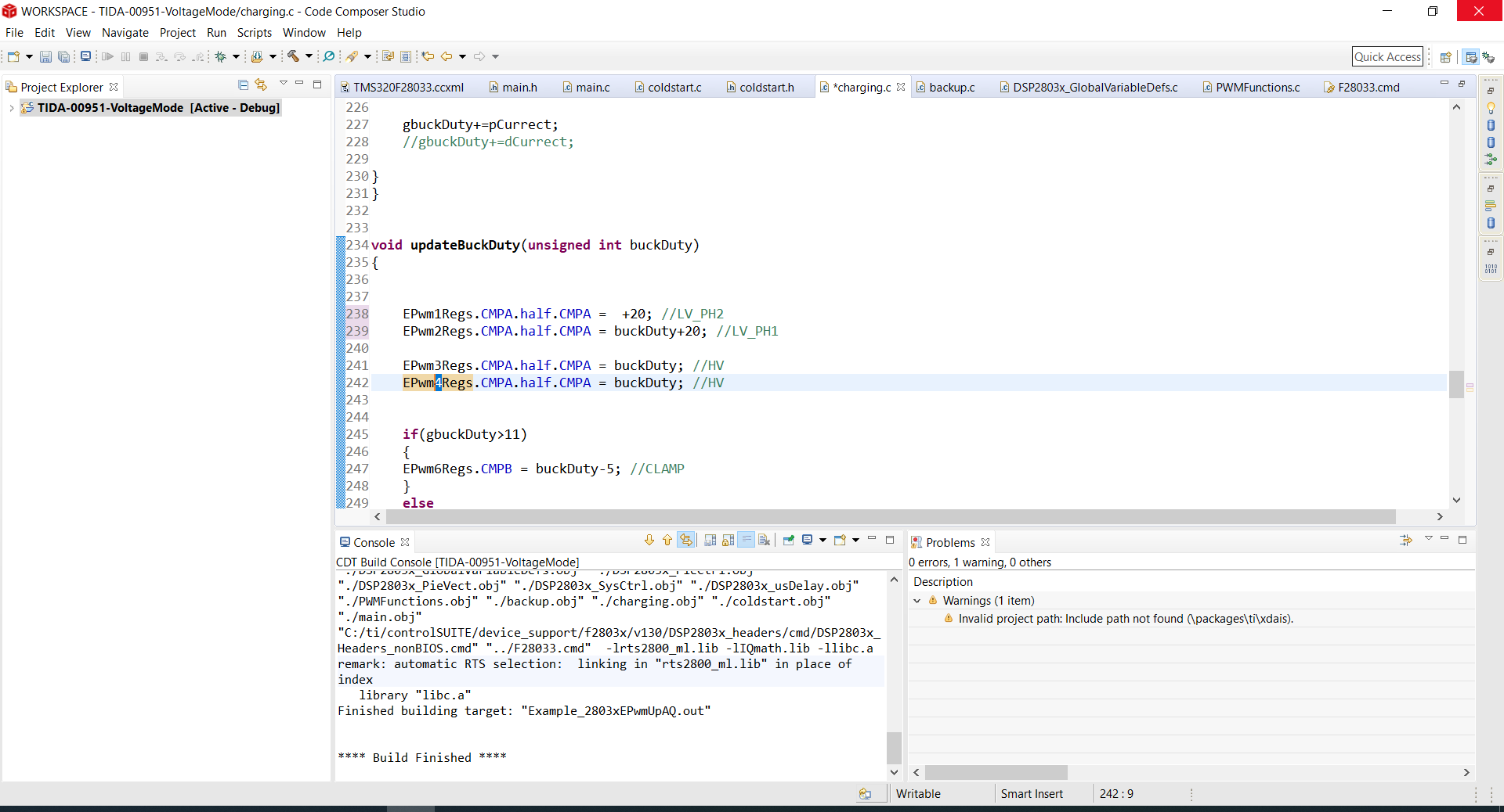

I noticed that PWM_ HV_PH2 didnt work at buck mode while PWM_ HV_PH1 is working, i can see that at the code comments HV_PWM_PH1/2 but one of the pwm is configure to PWM4 which is the the FLYBOOST PWM. I assume that it is a mistake.
also this mistake is going for all the buck function at the project.
