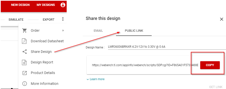

  • Hi Michel ,
    Could you please share the WEBENCH design link using the 'Share Design' option?
    Thanks & Regards,
    Praveen

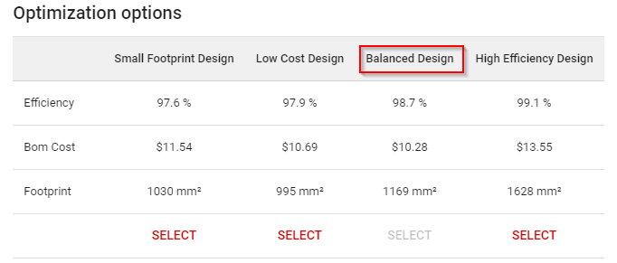

    The frequency range of LM5176 is 100KHz-600KHz.Since the 'Balanced' optimizer option is selected the mid-frequency(347KHz) is chosen. The frequency range is also dependent on minimum on/off time and FET selection.

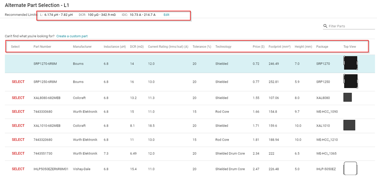

  • Hi Michel,
    The Lboost equation on the WEBENCH model is taken from the LM5176 Design calculator and it is different from the datasheet equation. However, it considers the peak-to-peak current ripple as 0.3 and calculates the inductor value as Lboost=7.82 uH.
    The recommended inductor range for the above condition on WEBENCH shown below.
    The Lmin is taken as minimum of two values: 6.17uH & 7.82uH
    L target is taken as an average of two values :(6.17+7.82)/2= 6.99 uH
    Lmax is taken as maximum of two values: 7.82uH
    The suitable inductor is chosen within the calculated limits.

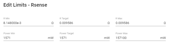

    I have just one question about RSENSE.
    Input data:    VIn max= 32V   Vin min=12V     Vout =24V    Iout = 3.5A  RT=23.7 Kohm  -->  FSW=340,23 KHz  inductor = 6,8µH
    IL(max)= 24V *3.5A/(0.9 * 12V) = 7.78 A   ( page 22 LM5176-Q1)
    IL(PEAK)= 7.78A +  12V*(24V-12V)/( 2 * 6.8 µH* 0.3402 MHz* 24V) =9.074 A
     So, I found
    RSENSE(BUCK) =  80 mV/3.5A = 22.86 mohm
    RSENSE(BOOST)  = 120 mV /9.074A= 13.22 mohm
    But the   WEBENCH RSENSE value is 9 mohm
     Could you please explain to me this difference ?
    Thanks a lot in advance for your answsers.
    Michel Thiébaut
    found now the correct value with the ponderation of 80%  for the inductor   Lbuck= 6.174 µH
    But for the L boost , I found  with the equation in the datasheet ( ponderation of 30 %)    Lboost  = 8.232 µH  > 7.82µH
    If this ponderation is 31.5% , so  the value of Lboost is 7.84 µH  -> is it the correct explanation for this difference ?
    I noticed also with the LM5176 DC/CD controller design tool  (VIn max= 32V   Vin min= 12V  Vout = 24V and Iout = 3.5A ) ,  the recommended Inductance is 7.9 µH and not 6,8 µH .
    In this case, the choice is made on the highest value of the two inductors Lboost and Lbuck ?
  • Hi Michel,,
    The difference in the Rsense calculation is observed because the WEBENCH has derated the values as shown below.
    RSENSE(BOOST)  = 120 mV*0.8 /9.074A= 10.57 mohm
    minimum of two values is selected = 10.57 mohm
    Rsense target= 0.9*10.57mohm= 9.57 mohm
    Rsense max= 9.57 mohm
    Rsense minimum= 0.85*9.57 =8.13mohm
    Thanks & Regards,
    Praveen
