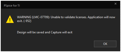

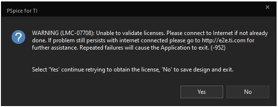

Hi experts,
I am having a licensing issue with PSpice. I have included a screenshot of an issue for further clarification. After the first window appears, the second window shows and my PSpice stops running. Any recommendations on how to clear this issue.

Francisco,
Would you please check if you have a license.txt file in %appdata%\Cadence\VBL\TI_PSpice_174\license (paste this into Windows file manager and it'll take you to the directory).
Also, please check your message. I need something else from your installation.
JC
Hi JC,
I do have the license.txt file in the folder location you provided. I have messaged you the requested information.

Francisco,
As discussed, the current fix is to uninstall and reinstall PSpice for TI. The problem will be fixed in the next release.
