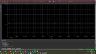

I make the simulation today with pspice for TI and the result shows the out is almost 0v, only about 20uV, I attached the project file here can you help to simulation and check it?

  • Hi Rick
    I think the root cause is the CS RES wrong value, it should be a RES < 3.2ohms, while you choose a 2.4k for R17 is too large.
    It will be a OC fault during the start up.
    And here are some advice for your simulation:
    follow below steps to check your simulation circuit :
    • Make sure that your connection is totally right and all the diodes direction is right;
    • Check your CS RES value is correct;
    • Check your feedback divider RES value are correct;
    • You can confirm your Res and Cap design and return to John recommendation before.
    Mia Ma
  • Hi Rick,
    Just we have noticed that PMP22557 design is not proper for a 5V output,  the circuit could not work.
    In PMP22557 design, VDD supply is charged by Vout through D1 and D2 while Q1 is ON. As you want 5V output, and considering of two diode forward drop, the VDD voltage is lower than Vvdd(off) minimunm value 7.3V. So the circuit couldn’t work and will enter a UVLO fault.
    So please change the design back to a Flyback topology, and you can refer to the UCC28730 EVM design:  https://www.ti.com/lit/pdf/sluub75
    Mia Ma
  • Hi Mia Ma, Thanks for the reply
    Yeah, got it, VDD is suggested about 9V in the datasheet. So I would reuse the standard 12V design. But the output is still abnormal
    Attach the 12V simulation project file here
    2388.UCC28730.zip

  • Understood ,thanks, the simulation file is ok for me, but the NMOS and Inductor models are not from tool library , I put them in the zip file attached, you want to add them to the design by editing the simulation profile->configure files->library files and then select the file and add to design.
    As this is a special design, I would like to see simulation result before release our board.
    1768.UCC28730.zip
