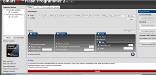

"Can you please let me know if my flash programmer detects the CC2640R2F chip of my custom board by looking into the pictures I have attached? How can I understand if the flash programmer 2 detects the chip?
Also, by looking into the picture of my connection, can you please let me know if it seems okay to you. I have connected the 10 pin adapter of the XDS110 to the 10 pin CC debugger connector. Can you please let me know if this is correct or not? Should I take out the CC debugger connector from the set-up?

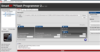

    "Hi It's good to know that our connection is okay. However, with our current connection we are getting errors in flash programmer 2 as I previously described (pictures attached). Flash programmer 2 does not automatically detect CC2640 R2F chip. I selected the target as CC2640R2F chips for the XDS-1110 debugger, and when I select the connect option I got those errors. It would be a great help if you could kindly forward the errors to TIDA teams, so that I can know how and what should be changed in the device setting. Also, I wanted to know if I have to change anything in the software settings in flash programmer 2?

  • Maynard,
    Please apologize for the delay;
    From the screenshots, the error message indicates the selected entry on the tree on the left is not the XDS110 entry but instead the UART.
    The error message gives away this issue, which mentions the serial connection and bootloader:
    "Connecting over serial bootloader failed: No response from device. Device may not be in bootloader mode. Reset device and try again. If problem persists, check connection and baud rate."
    To fix this, please select the top entry as indicated in the screenshot below:
    If this does not work, I can see the serial number of your XDS110 is set to 00000000 (where it reads L50000NP on my screenshot) and this may cause some trouble depending on the scenario. If you need some help in setting a serial number, please check the section Finding and updating the serial number of the XDS110 page at:

  • Maynard,
    The last step the customer tried may have bricked his XDS110 Debug Probe. I never asked him/her to update the bootloader but only set the serial number, which is not shown in the screenshot.
    At this point the pod is either bricked or the OS is not acknowledging it properly. There is a procedure to check its status and restore a bricked Debug Probe in the section TroubleshootingFlashing the bootloader of the XDS110 Page I sent before. Check the steps there.
    Regarding the prior errors shown in the document, the error in CCS can be found at the Debugging JTAG page below (search for the error number):
    https://software-dl.ti.com/ccs/esd/documents/ccs_debugging_jtag_connectivity_issues.html
    Based on the photograph of the system itself, the wiring itself looks very long and very busy between the Debug Probe and the target board, which can cause signal integrity issues. The customer can experiment changing the JTAG TCLK speed to see if the integrity helps. The short clip below can help with this:
    https://youtu.be/mKxaztkCsYw
    In the last pictures, the customer still showed trying to connect using the UART entry.
