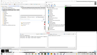

  • Hmm.  I have built the 2640 project zero example.  I've ran both the TI and the punchthrough app.  Neither show a bluetooth device named "project zero r2" as shown in this page
    https://dev.ti.com/tirex/explore/node?node=AAliBv1MZ54NaV.m2AIT8w__krol.2c__LATEST
    Here you can see the code running on the cc2650 launchpad.  Pity I cannot show a screenshot of my phone.
  • Well this cc2640rlp setup does build but it does not work.  It seems broken.  The debugger does not have a pause button operational when running.  Ive used the built in IDE for a terminal program as well as putty.  I've tried to connect to both comm ports and neither shows any output when examined during boot and/or debug operation.   By the way, docs say to connect to the comm port but not explicitly say which particular port to use.  I'm referring to this guide:
    dev.ti.com/.../overview.html
    Here you can see the two comm ports in device manager, the blank screen is com3 at 115.2k and the comm4 is shown in the IDE, and the IDE with a disabled pause button.
    I keep thinking about the lead in text for the docs where it says this lab can be completed in two hours.

    To be honest at this point, I'm not surprised this does not work.  I'm using an IDE built years ago, usingg docs as a reference which specify version 5 for a processor that does not match the eval board.  And why am I doing this?  Because the sample has been pulled from the boards eval board yet the staff insists its supported.

  • I said CC2640 is binary compatible, but not CC2640R2F. Those are 2 different devices as can be seen in the product list: https://www.ti.com/wireless-connectivity/bluetooth/products.html
    For CC2650 you must download the BLE Stack here: https://www.ti.com/tool/BLE-STACK . It comes with everything you need and there is a link to the appropriate version of Code Composer Studio in the download section as far as I can see. Try running the SimplePeripheral project for example.

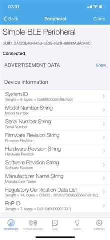

  • Challenge accepted.
    I dusted off an old CC2650 LaunchPad I had lying in a box. I have not used it for years and I do not have the right version of CCS or the BLE Stack installed already. I am on a Mac so I am running Windows 10 in a virtual machine. (Note btw. that SDKs for CC2640R2F and later support Mac and Linux).
    1. I went here: https://www.ti.com/tool/BLE-STACK and downloaded BLE Stack v2.2 and CCS (both found in the download options tab).
    2. Install CCS (default options only, and I selected only CC13xx/CC26xx device support).
    3. Install BLE Stack v2.2
    4. In CCS: Project -> Import CCS Projects -> Browse -> c:/ti/simplelink/examples/cc2650lp/simple_peripheral (it was with underscore) -> ok
    5. Tick off both ..._app and ..._stack -> click finish
    6. Select the stack project -> click debug (the button with the green bug). This will build and download the project, but it will complain about not finding main(). That is ok, simply click terminate (button with red rectangle, or CTRL-F2). It also asked to update my debugger, I accepted.
    7. Select the app project -> click debug.
    - Here I actually encountered a problem as CCS claimed the right TI-RTOS was not installed. Not true since it comes with the BLE Stack. I did find the solution here though: https://e2e.ti.com/support/tools/code-composer-studio-group/ccs/f/code-composer-studio-forum/792184/ccs-cc2640-com-ti-rtsc-tirtoscc13xx_cc26xx-v2-21-1-08-is-not-currently-installed
    8. Click resume (button with yellow-green arrow, or F8).
    9. Simple BLE Peripheral appears in the LightBlue app on my phone.
    More details about the process are found in the documentation: https://www.ti.com/lit/pdf/swru393

    Clément has commented on your attempts in your other thread: https://e2e.ti.com/support/wireless-connectivity/bluetooth-group/bluetooth/f/bluetooth-forum/1011998/launchxl-cc2650-in-2021-what-hardware-software-combination-does-ti-test-for-bluetooth-development
    Your tone and attitude does not really encourage helping you, I did it mostly to prove your claims about lack of support wrong (I see you have redacted several of your posts now so you may have realized this yourself already?).
    There are thousands of users of the CC2650, both professionals and hobbyists, so maybe the source of your struggles lies not only with TI?
