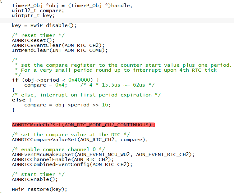

Question 1:When using  CH0 of the cc2652p RTC timer, because the program created a clock during startup, the callback function cannot be updated when it is used again, because the clock uses a global value instead of a handle in the callback function.
1) Using the path for the first time
Power_init()->ClockP_construct()->ClockP_start()->TimerP_construct()
The screenshot is as follows:
When using this function for the second time, the TimerP_handle variable cannot be updated, and the callback function cannot be replaced because the callback function uses a global variable instead of a handle。
Question 2:When using RTC's ch2 continuous mode, the callback function does not trigger according to the set comparison value, but triggers every tick。
Channel 2 settings:
Set comparison value:0x800000
Register status
