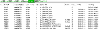

I am having a problem with MacOS 11.4 prematurely disconnecting its BLE connection from our CC2640R2-based device.  I'm not entirely sure what is causing the disconnect, but it looks like it might be related to the Mac rejecting a LL_CONNECTION_PARAM_REQ request as shown in the following capture:
The disconnect doesn't happen until around 40 seconds after the LL_CONNECTION_PARAM_REQ is rejected.

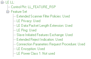

For comparison, here is a successful connection on a different version of MacOS.  Note that the LL_FEATURE_REQ/RSP indicates that the ‘Connection Parameters Request Procedure’ is supported.  Shortly afterwards, we send a LL_CONNECTION_PARAM_REQ to the Mac, and it handles it just fine.
For the failed connection, the mac does not send me an LL_FEATURE_REQ, so I don’t know if it supports the ‘Connection Parameters Request Procedure’.  Unfortunately, we still send the LL_CONNECTION_PARAM_REQ to the Mac, which is rejected and may possibly cause the connection to be terminated.

  • Is the rejection of the LL_CONNECTION_PARAM_REQ causing the disconnection?
  • Is there a way for me to prevent sending the LL_CONNECTION_PARAM_REQ to the Mac?
