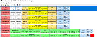

Below is the sniffer log for the issue:
disconnect issue - no terminate link.psd
LOG ANALYSIS:
Below is the image from the log and here no terminate link is seen on the logs.
And also we are getting ACK STATUS as RETRY till the BLE is switching to advertising again.

  • Hi Saurav,
    Thank you for the guidance... I managed to make a confusion between PACKET SNIFFER and PACKET SNIFFER 2... As we say in French "shoemakers children are the worst shod".
    Here are a couple of observations:
    • at packet #1449, I see the peripheral sending a Start_Encryption_Req then everything is properly encrypted
    • the last proper packet sent out by the peripheral is #1462. After this, the central (phone) only sends out packets that are never acknowledged.
    • I guess the retries occur until the connection timeout. Then the peripheral gets back advertising

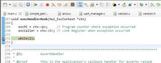

    There is an update on this disconnect issue.
    We were able to put our board in debug mode and when we tried to reproduce the issue than it was seen that the exception is coming when the issue is reproduced.
    While debugging we were able to find that we are getting an exception when the issue was reproduced.
    Below is the snapshot of code when the exception was found:

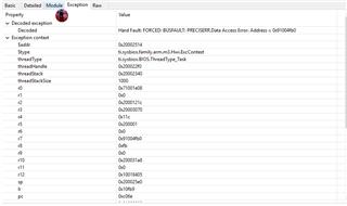

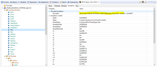

    Please find the below snapshot of some exceptions we are observing:
    Every time the  exceptions are due to “Hard Fault: FORCED: BUS FAULT: PRECISERR.Data Access Error” but different Exception call stacks were observed.

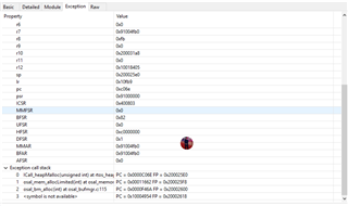

    Below is the snapshot of Fault:

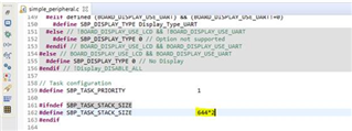

    We have tried to resolve the issue by updating the Program stack in “cc2640_r2_csdk.cfg” from 1024 to 2048 but the issue was not resolved.
    We have also updated the “SBP_TASK_STACK_SIZE” in Simple_peripheral.c from 644 to 644*2, but still we are getting the same exception.

  • Hi Saurav,
    Well done! You seems to be on the right path to get this debugged. It was a good idea to use the ROV to get more information about the issue. Now you have to use this information to locate the issue.
    Based on the details you have provided and the help provided on our debugging guide, it looks like you are doing an illegal access to address 0x2d0007 - I assume you are trying to write this address (located in flash). The illegal access is made at address 0x10792 (cf. PC register).

  • Hi Clément,
    We have followed the steps you have mentioned.
    Below are the snapshots of one of the exception found:
    Below is the code snippet where the issue is found:
    This code file is not changed by our project at all.
    So, we are not able to know why the exception is coming in this code line.
    Saurav
    Saurav
    Not sure I can spot the issue given the small snippet provided. Could you please specify, the address of the variables hdr and tmp, their addresses?
