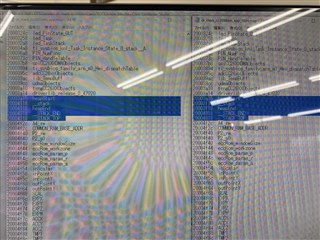

    How to set the stack value, is it right to set just as the following figure show? The customer has calculated 2307, but it shows 256.
    And customer has adjusted the heap size and stack size, 0x800. And there is no change after checking the map.
    How is this setting reflected in the program?

    And the customer finds there is still space left for the sram display of the map file, could you please help to check this? Thanks.

    The heap is allocated on the remaining RAM. It may not appear in the map file.
    You can review the linker command file (.cmd) for more details on the way RAM is allocated.
