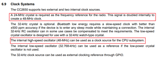

Because I need to accurately record the time stamp in the program, I am now learning the clock source of CC2650.
Through studying the datasheet and TRM, I understand that there are two external clock sources XOSC_HF and XOSC_LF and two internal clock sources RCOSC_HF and RCOSC_L.
Through studying TI-RTOS kernel user guide, I understand that there are four clock modules Clock, timer, seconds and timestamp.
I plan to use clock to record timestamps, but I don't know which clock source enables the clock module. I observed that there is such a paragraph in the datasheet:
does it mean that the clock source of the clock module can be configured as XOSC_HF or RCOSC_HF? Because I understand that the stability and accuracy of the crystal oscillator are higher than that of the RC oscillator, I hope that the clock source of the clock module can be configured as XOSC_HF. How should I implement this in TI-RTOS?
