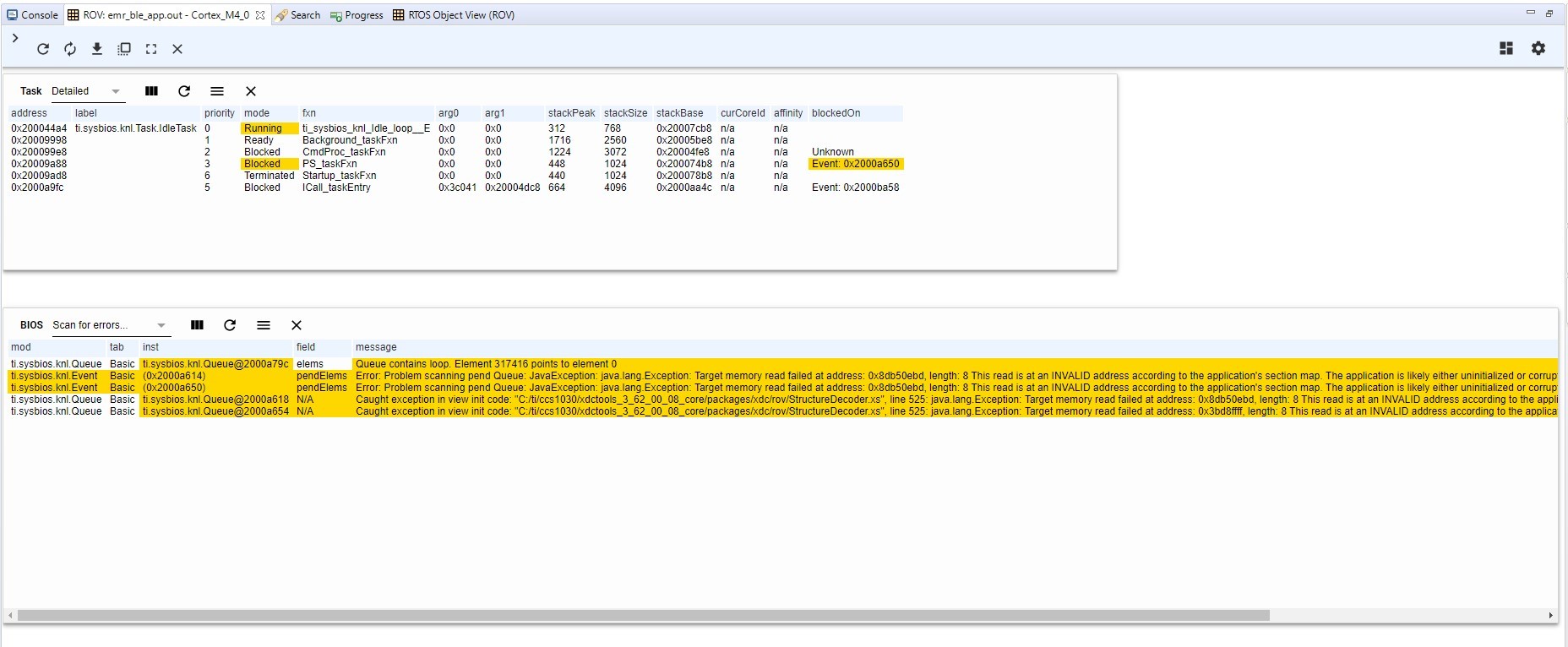

I am working on the TI SDK v5.10 with CCS IDE v10.3.0, using Simple Peripheral example as base code for my application.

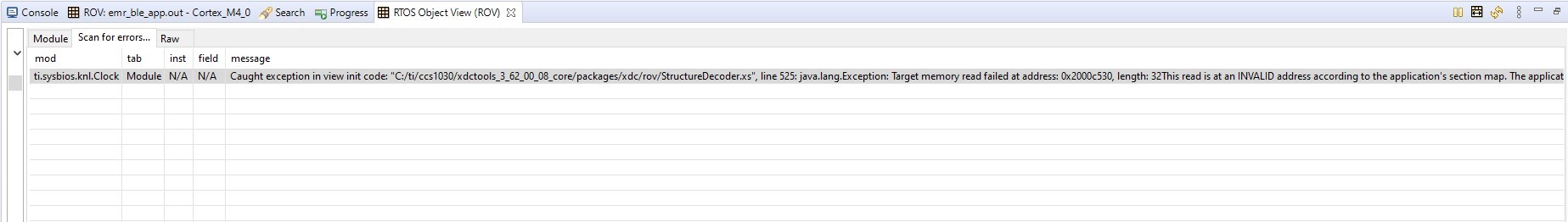

While running the ROV and ROV2(ROV Classic) during debug session for my application, I am getting following error :
        - ROV in BIOS's "Scan for Error" window: INVALID Read Address and Read Failed for "C:\ti\xdctools_3_62_00_08_core\packages\xdc\rov\StructureDecoder.xs"
                - ROV2(ROV Classic) in BIOS's "Scan for Error" window : Issue in the ti.sysbios.knl.Clock module
From the error description, it seems, it is coming from TI implemented module or file. Can you please look into this and let us know, what might be causing this error?
It is consistence throughout the debug session but my application works fine as expected.

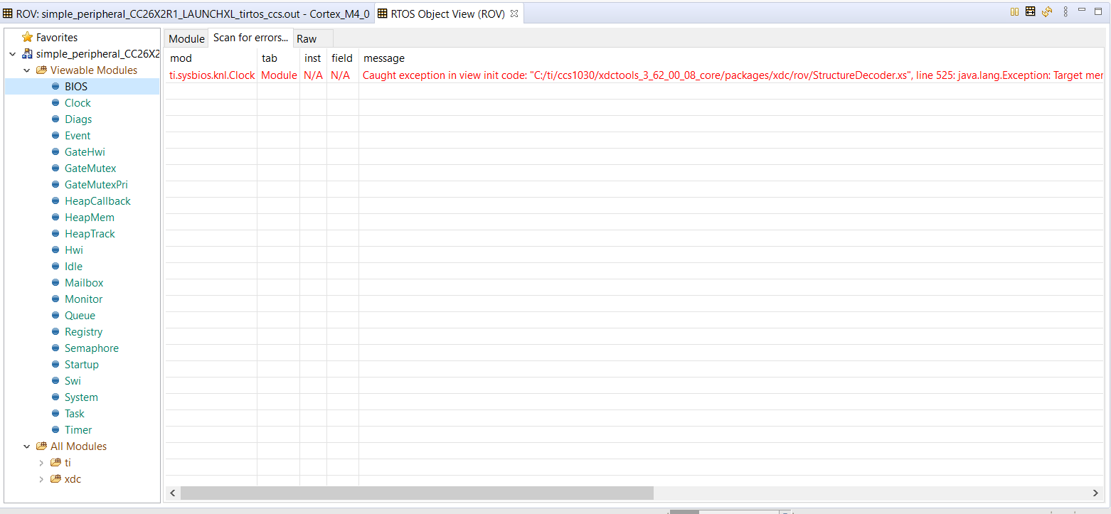

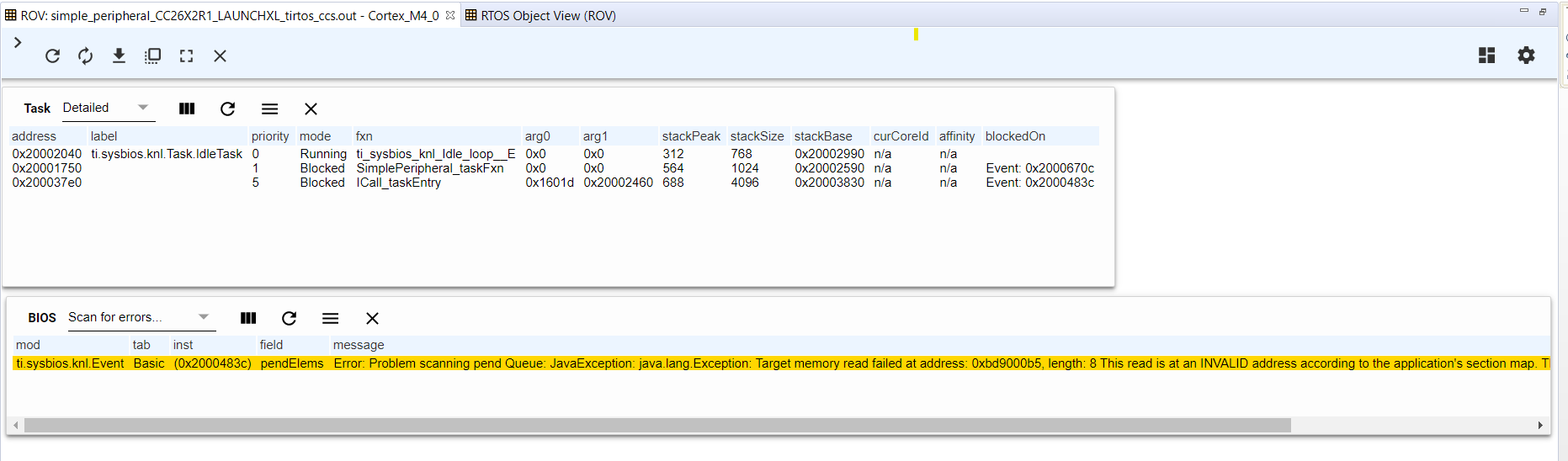

  • Please confirm whether or not you are observing any similar ROV issues with the default Simple Peripheral example
    I was able to reproduce the issue on Simple Peripheral example code (see below)
    Classic ROV:
    ROV :

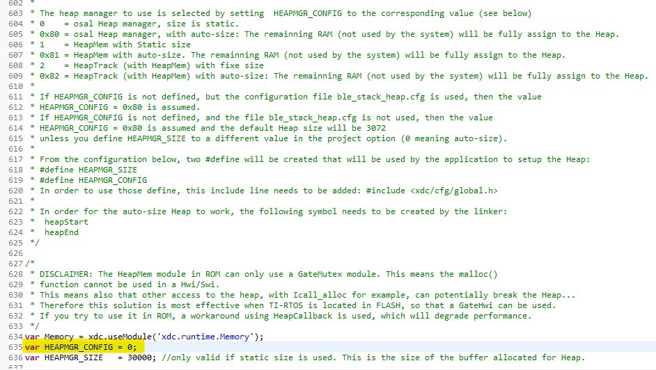

    I also recommend that you evaluate a static heap configuration to evaluate whether the issue persists with this setting
    As you suggested, I have modified the setting to "Static Heap Configuration"(see below, .cfg file screenshot) and still facing the same issue.

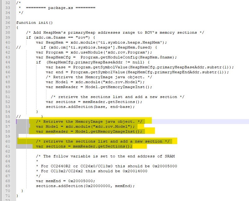

    there are workarounds involving modifications to the package.xs file which can be considered as well.
    I have also tried out modifying the "function init()" in the package.xs file as suggested in the https://dev.ti.com/tirex/content/simplelink_cc13x2_26x2_sdk_3_20_00_68/docs/ble5stack/ble_user_guide/html/ble-stack-5.x-guide/debugging-index.html#workaround-for-rov (see below, modified package.xs screenshot)
    I am still facing the issue after trying out all the workaround but still facing the same issue. And my firmware is working as expected without any issue(i.e. without any assertion or any undefined behavior ).
