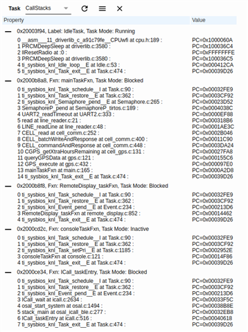

Our CC1352 running TI RTOS occasionally gets reset by the watchdog in the field. We must have a bug that locks up the task responsible for clearing the watchdog.
If we were able to reproduce this in our lab, we could connect via JTAG and use the Runtime Object Viewer (ROV) to examine the call stack for the problematic task.
Unfortunately, this problem is difficult for us to reproduce, so we would like to add more logging to our devices in the field.
What data does the ROV use to display the call stack for each RTOS task? What is the best way to access this data from our application so that we can save it to an external flash?
