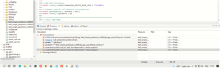

I am facing issue in building my project.
Hi Rohit,
Clean your project first, then I recommend that you start with an out-of-box example and confirm that it works. You can then compare the Project Properties -> CCS Build -> Arm Linker -> File Search Path differences between the example and your code. Please note that CC2640R2 BLE5 OAD is highly discouraged: https://e2e.ti.com/f/1/t/1072788
