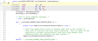

    Thanks for your reply! And sorry for not clarifying the details: the program is not stuck at very beginning, actually it fails at the freeRTOS call "prvPortStartFirstTask". I did some debug with OZone, it shows it fails in timer task:
    I had thought it's caused by BLE stack, but it still has same issue even I disabled the BLE tasks.
    BTW, I also tried the way to ddisable "auto-check" in CCS, it got same result as OZone.

    Thanks for the additional details. The interesting aspect at this point is that the fault happens after the code initialization. I am not entirely sure what the FreeRTOS call does, but since you mentioned it fails on the timer task, I still suspect the timer was somehow not properly initialized.
    If you only see this behaviour with the Jlink, I still wonder if a complete cold reset (from power down) would clear this condition. The reason I mention this is because a number of resets do not initialize peripherals (timers, UART, SPI, etc.). Otherwise, I would have to defer this to someone in the software team that is more experienced in FreeRTOS and in particular in this API.
