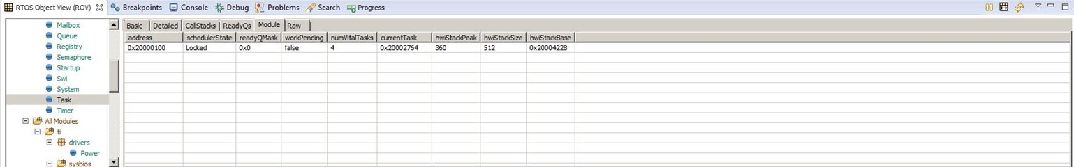

    Can you decrease any other stacks so that you can have room to increase the Program stack?
    Sorry, I incorrectly stated that Program.stack sets the IdleTask stack size. (I have edited my previous post to correctly refer to it as the IdleTask stack).
    I have done a lot of research to figure how to increase the IdleTask stack size and still have not found out how to do this.
    Do you know how to  increase the IdleTask stack size?

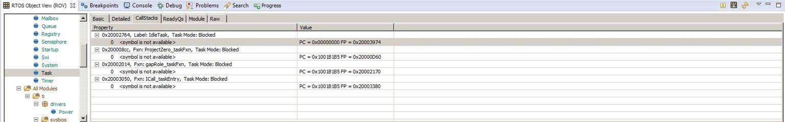

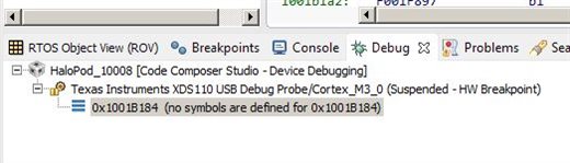

    I was able to rearrange to stack sizes (except for ICall_taskEntry stack which also still alludes me as to how to change its's stack size) and now, after waking from sleep and stepping through code, I have no more stack errors:
    BUT, the code is stuck in a loop going through the above 4 lines 1001b180 to 1001b188 repeatedly forever (or at least as many times I have paused execution and pressed F5 till my fingers got sore.
    There may be these other few clues for someone in ROV but I do not understand their relevance:
    Can you help drill down more or suggest a new topic name?
    Dale

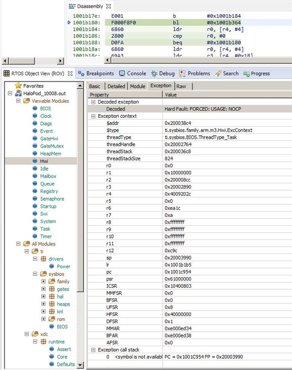

  • Thanks, actually I already have a  void execHandlerHook(Hwi_ExcContext *ctx) function in my code and it is not being triggered with my current behavior.
    During my behavior (4 lines looping), here is the Exception tab of hwi in ROV:
    NOCP is hard to find info on, one person suggests it is defined as no coprocessor found error but also states that it is used as a catch all sometimes...
    Is "Hard Fault: FORCED: USAGE: NOCP only AFTER waking up from a sleep/standby state" the appropriate new topic title?
    Dale

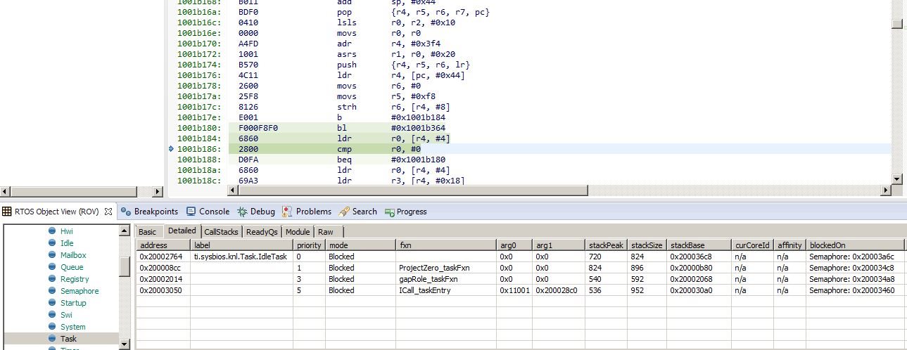

  • Are your .cfg settings using BIOS in flash or ROM?  And have you tried debugging while adding RTOS ROM symbols? https://www.ti.com/lit/swru393
    Ryan
    I do not know, how can I tell?
    EDIT: My cc2640.cfg is set up for BIOS in ROM
    The ROM symbol file was not in the location in that document, I loaded it from C:\ti\tirtos_cc13xx_cc26xx_2_20_01_08\products\bios_6_46_01_38\packages\ti\sysbios\rom\cortexm\cc26xx\golden\CC26xx\rtos_rom_syms.xem3
    The below disassembly listing with ROM symbols added starts with the first ROM symbol a little before my 4 line loop at lines 1001b180: to 1001b188: and goes to 1001b364: where the 4 line loop sometimes exits to (yes it is not an endless loop as I previously stated):

  • Have you made any changes to the .cfg which may require the BIOS to be in flash instead of using the pre-configured ROM settings?  Are you able to view your call stack during the debug session to further deduce how your code ended up at its current location?
    Ryan
  • I tried remming out the appropriate code section in cc2640.cfg so that I would have BIOS in flash but the code compiled with the exact same FLASH and SRAM usage.  Also, the behavior after wakeup is not changed.
    My rem out change:
    /* ================ ROM configuration ================ */
     * To use BIOS in flash, comment out the code block below.
    if (typeof NO_ROM == 'undefined' || (typeof NO_ROM != 'undefined' && NO_ROM == 0))
      var ROM = xdc.useModule('ti.sysbios.rom.ROM');
      if (Program.cpu.deviceName.match(/CC26/)) {
          ROM.romName = ROM.CC2650;
      else if (Program.cpu.deviceName.match(/CC13/)) {
          ROM.romName = ROM.CC1350;
    I compared my current cc2640.cfg with one in the rollback directory C:\ti\simplelink\rollbackBackupDirectory4\C\ti\simplelink\ble_sdk_2_02_01_18\src\common\cc26xx\kernel\cc2640\config
    The only differences are that I have set up an exception handle long ago, I set Program.stack to 512 relatively recently as a result of another forum topic I had and I now have recently in this topic set Task.idleTaskStackSize to 818.
    If you mean from the Debug tab in CCS here it is (not many levels ;), otherwise how to I view my call stack in more detail?
  • Thanks for providing the additional information.  Unfortunately I can't determine any more from the call stack if the ROM symbols have already been enabled.
    It seems that your code is transitioning from ti_sysbios_knl_Task_schedule__I to ti_sysbios_knl_Task_allBlockedFunction__I.  You can find some details from the ti.sysbios.knl.Task module of the TI-RTOS Kernel Runtime APIs and Configuration (cdoc)
    config Task_allBlockedFunc  // module-wide
    index URL
    Function to call while all tasks are blocked
    C synopsis	target-domain
    extern const Task_AllBlockedFuncPtr Task_allBlockedFunc;
    DETAILS
    This function will be called repeatedly while no tasks are ready to run.
    Ordinarily (in applications that have tasks ready to run at startup), the function will run in the context of the last task to block.
    In an application where there are no tasks ready to run when BIOS_start() is called, the allBlockedFunc function is called within the BIOS_start() thread which runs on the system/ISR stack.
    By default, allBlockedFunc is initialized to point to an internal function that simply returns.
    By adding the following lines to the config script, the Idle functions will run whenever all tasks are blocked:
      Task.enableIdleTask = false;
      Task.allBlockedFunc = Idle.run;
    SEE
    enableIdleTask
    CONSTRAINTS
    The configured allBlockedFunc is designed to be called repeatedly. It must return in order for the task scheduler to check if all tasks are STILL blocked and if not, run the highest priority task currently ready to run.
    The configured allBlockedFunc function is called with interrupts disabled. If your function must run with interrupts enabled, surround the body of your code with Hwi_enable()/Hwi_restore() function calls per the following example:
      Void yourFunc() {
          UInt hwiKey;
          hwiKey = Hwi_enable();
          ...         // your code here
          Hwi_restore(hwiKey);
    This will take further investigation of the task scheduler and determine how/why all tasks remain blocked.
    Ryan
