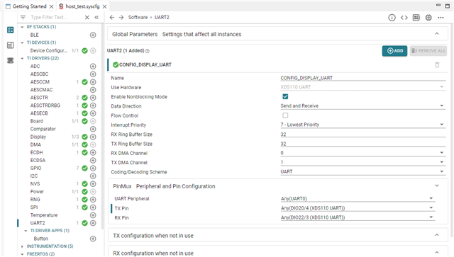

UART pin mapping for CC2340R5
Other Parts Discussed in Thread: SYSCONFIG, CC2340R5, UNIFLASH
My product only uses UART to connect to CC2340.
How to set up can be consistent?
Bootloader mode: UART Dio6 and Dio20
host_test application: UART Dio20 and Dio22
Currently the CCS setting 'Use Hardware' cannot be changed

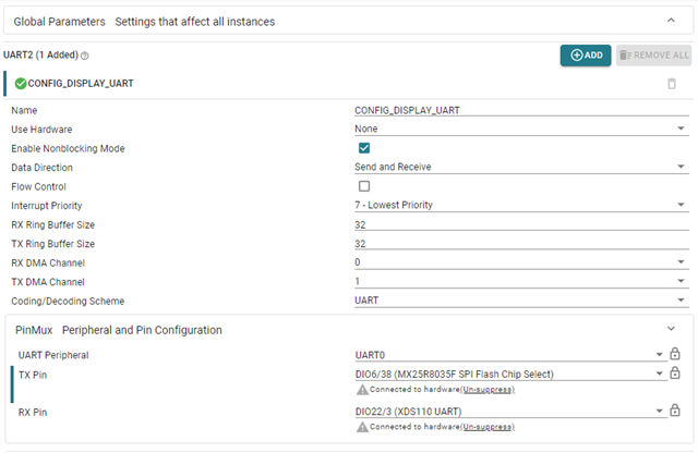

    Option 1: reconfigure the host_test code to use other pins for the UART. To doi so, open the CCS project and follow the steps:
    • Verify in NPI/Transport/UART/npi_tl_uart.c the UART instance used by the NPI (should be CONFIG_DISPLAY_UART)
    • Open the .syscfg file.
    • Click on UART2
    • Check the configuration for the UART instance used by the NPI (CONFIG_DISPLAY_UART in our case).

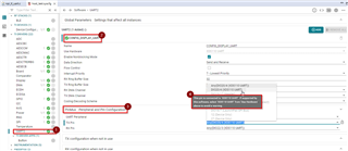

    • Open the menu "PinMux" and try to modify the pin used.
    • It is likely the configuration is actually blocked by something else  (here, the Display driver)
    • So open what is blocking (i.e. Display) and change its configuration "Use Hardware" to "None"
    • You can then go back to UART2 and modify the configuration
      A warning may be raised but can be discarded for evaluation.
    • Last but not least, I have noticed the UART interface has been renamed in the process (might be a mistake from my end as I only reproduced once). In that case, you'll have to revert the name to its initial name (i.e. CONFIG_DISPLAY_UART)

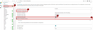

    Option 2: modify CCFG configuration so you use the same UART pins as host test.
    • Looking at the following image, the configuration #2 should correspond to the configuration you want
    • The CCFG configuration can be set in the SysConfig file:

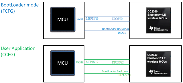

    I have a confusion about the hardware layout.
    Use FCFG case: If the flash is empty or the CCFG is damaged, the user needs to upgrade the image.
    Use CCFG case: Trigger bootloader  backdoor.
    Do you suggest the layout of my product, set UART on DIO6/20 pin?
    Do you suggest the User application, set UART on DIO6/20 pin?
    Aries

    Case4: If the hardware wants to change to CC2340 TX:DIO6  RX:DIO22  Backdoor:DIO24
         XDS110 (TXD)  <----> (DIO22) CC2340R5
         XDS110 (RXD)  <----> (DIO6) CC2340R5
    1. Reconfigure the host_test code
    How many values should be set for Serial IO Configuration Index?????
    2. Btool can set CC2340R5 through UART.
    3. Trigger Dio24 active low and reset CC2340R5 board and send 0x55 0x55 using Teraterm but no data received.
    Thank you for your patience.

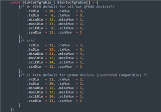

    I am afraid this is not a possible configuration for the ROM bootloader.
    May I kindly ask if there may be a typo? One possible configuration is TX:DIO6  RX:DIO20  Backdoor:DIO24
    For information, the configuration TX:DIO6  RX:DIO20 is the default configuration on CC2340R5 5x5 pre-silicon material. This configuration can also be selected by chosing the configuration 0 of the bootloader.
    If it helps, the other bootloader configurations possible are:
    • 0: RX:DIO20    TX:DIO6
    • 1: RX:DIO12   TX:DIO13
    • 2: RX:DIO22   TX:DIO20

  • Hi Aries,
    Whether it is possible to program CCFG is to set a specific UART pin?
    I am afraid this is not possible.
    The three available settings have been mentioned before:
    One option could be to consider rewriting the bootloader in Flash so you can use any of the UART configuration allowed by the device.
