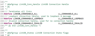

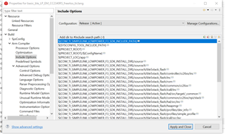

We are working on migrating an old project from CC2640R2F to CC2340R5.
I tried to use the same function from CC2640R2F in our new CC2340R5 project which is based on  the basic_ble example project.
But I got following errors:
error: use of undeclared identifier 'CONNHANDLE_ALL'
GAP_CB_REGISTER, CONNHANDLE_ALL);
I could find the "CONNHANDLE_ALL" defined under INCLUDE/linkdb.h like below:
But I had no idea where did this file come from?
And where should I define the same item in CC2340R5 project while I currently use basic_ble sample project and there's no INCLUDE/linkdb.h by default.
Shall I manually copied the file to CC2340R5 project or shall I create a header file to put those missing definitions?
