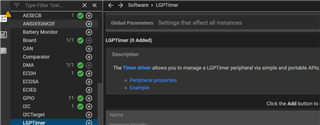

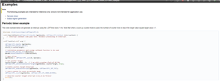

    For the Driverlib example, or more examples on how to use timers please navigate to your syscfg, into LGPTimer and select "Example" which will bring you to a local website with more details on how to configure and use the timer.

    Customers should reference the LGPTimer, and GP timer to achieve timer needs generally (for 7.40 SDK). Unfortunately, there is not a current example in the SDK itself that displays how to use the timer, but the examples in the separate local webpage should help getting started.

    Note that it's very hard to find the documentation example that you pointed out. Well, it's easy if you click the link in the SYSCONFIG tool. But very difficult otherwise. FWIW, it's nearly impossible to find online or when starting from the "Documentation Overview" webpage.
