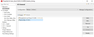

I followed the setup for SimpleLink Low Power F3 SDK Environment Setup Guide for the LP-EM-CC2340R5 and the LP-XDS110ET.
When I go to build the "basic_ble_LP_EM_CC... " program I get the error .../.metadata/product.json file does not exist
Thank you for reaching the support,
I think you have the wrong version of SysConfig, You should use version 1.18.1 for the Low Power F3 7.40.00.64 SDK. Can you go to Project Properties > CCS General > Products and change SysConfig version to 1.18.1 and see if the problem still occurs?
