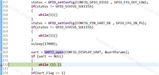

I tested the UART function every minute in the basic_ble project of SDK: 7.40.00.64. When I open the UART for the first time, it's normal, then I also called UART2_close() to close it, but as long as I called sleep() or usleep(). As a result, my second call to UART2_open() failed. I used the Debug mode to check and found that object->state.opened in UART2_open() was set to true, resulting in return NULL, but I am sure that after I called UART2_close() , object->state.opened is set to false, but it will be set to true after calling sleep()。

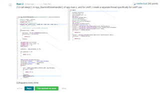

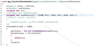

  • (1)I call sleep(1) in App_StackInitDoneHandler() of app.main.c, and for UART, I create a separate thread specifically for UART use.
    (2)happens every time

    I found that such a situation can also be found in the UART's own thread. It seems that it does not necessarily happen when a different thread calls sleep(), and I tested that this situation will occur as long as the setting exceeds usleep(16000), but I have other Setting sleep(1) locally will not affect it, which is quite strange. It may be triggered or certain conditions are reached before UART2_open() cannot be opened, and I use single-stepping UART2_open() to view the inside of the function. , it seems that the reason is that UART determines object->state.opened == 1

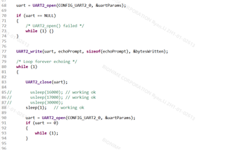

    ^ I used the above code in the default uartecho example (C:\ti\simplelink_lowpower_f3_sdk_7_40_00_64\examples\rtos\LP_EM_CC2340R5\drivers\uart2echo)
    Can you try this on your end to see if you can reproduce my results? (Successful, repeated UART2_open and UART2_close).
    Toby
  • Hi Toby,
    I use uart2echo and add the Code you provided and modify it slightly (because I use QFN-24's CC2340R5), UART2_open() can run successfully, but the project I am currently using uses basic_ble_LP as the base project
    But as I mentioned above, it seems that not every sleep() will affect UART2_open(), because I have used sleep(1) in many places, but it will not affect UART2_open()

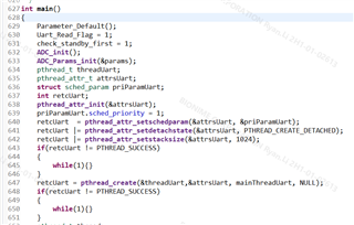

  • I have described above how my UART thread is created and how it works,
    The code written in my uartthread is just the picture, so there is no other place to open UART2_open(), and if according to your assumption, there are other places to repeatedly open UART2_open(), then how to explain the use of usleep(16000) can it work normally? This doesn’t make sense
  • What does "mainThreadUart" look like?
    Are you using UART only one time, then closing it? (during app initialization, as indicated by "App_StackInitDoneHandler")
    Or is App_StackInitDoneHandler called multiple times?
    My assumption was that mainThreadUart would access the UART (open then read/write), then when it is done, close UART.
    And that this happens more than once.
