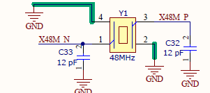

Controller: CC2340R5Q1(32 pins)
Kindly suggest "HFXT Cap Array Q1" Value and "HFXT Cap Array Q2 Value"(What should i mention this value). Kindly also help us for the calculation.

Hi Divyani,
I cannot give a value for HFXT Cap Array as it will be different for different designs, but I can tell you how you can determine this value yourself.
You can use SmartRF Studio 8 to set the device to send an unmodulated carrier wave and then you can measure the frequency offset. After that, you can change the Cap Array values until the frequency offset is at around 0 ppm.
