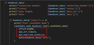

We are implementing the connection handover feature using SDK version 9.11, with two CC2745R10 devices acting as the serving node and candidate node, and a mobile phone as the peer node. The serving node data is transferred to the candidate node via CAN. Upon receiving the data, the candidate node sets the following four parameters (same as the car_node demo, except for the last one) and calls Handover_startCandidateNode() to initiate the handover.
With these settings, the candidate node reports the BLEAPPUTIL_LINK_ESTABLISHED_EVENT to the application, but soon after, it reports BLEAPPUTIL_LINK_TERMINATED_EVENT. The disconnect reason is 0xFD(0xFD means LL_STATUS_HANDOVER_FAILED as defined in ll.h), and the status received in HandoverExtCtrl_startCnEvtHandler() is 0x3E.
We have tried various configurations for timeDelta, timeDeltaErr, maxFailedConnEvents, and txBurstRatio, but the results are inconsistent. Sometimes, the same issue occurs; other times, the disconnect reason changes. For example, with another set of parameters as bellow, the candidate node still reports BLEAPPUTIL_LINK_ESTABLISHED_EVENT followed by BLEAPPUTIL_LINK_TERMINATED_EVENT, but the disconnect reason becomes 0x3D(0x3D means LL_STATUS_ERROR_CONN_TERM_DUE_TO_MIC_FAILURE as defined in ll.h), and the status in HandoverExtCtrl_startCnEvtHandler() is 0x00.

    Firstly, what is the reasoning for fixing these variables? It seems you don't desire a specific value, so why not just keep the values the default? See the image below:

  • Hello Isaac,
    Thank you for your response.

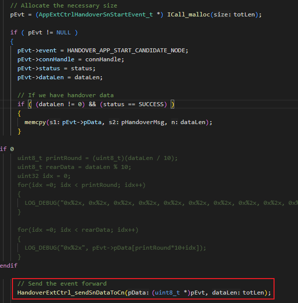

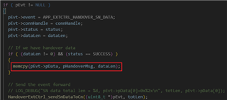

    For your first question, we noticed that these variables are fixed in the `ble_device_connection_handover.py` script, as shown in the image below.
    Additionally, the `handover_data["data"]` in the script corresponds to `pEvt->pData` in the `HandoverExtCtrl_startSnEvtHandler()` function of app_extctrl_handover.c, as shown in the second image.
    Therefore, we fixed these variables, but the actual handover data is still coming from the serving node.

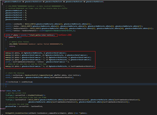

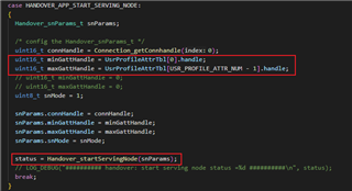

    We use a CAN message to initiate the handover process. Upon receiving this message, the serving node calls Handover_startServingNode(), as shown in the attached screenshot. The minGattHandle and maxGattHandle are calculated as indicated by the red rectangles.
    After that, we obtain the handover data in HandoverExtCtrl_startSnEvtHandler, and then call HandoverExtCtrl_sendSnDataToCn to send the data to the candidate node using 5 CAN messages. In my case, the handover data length is 276 bytes, and the size of AppExtCtrlHandoverSnStartEvent_t is 12 bytes. We also append a 1-byte checksum (calculated over the previous 288 bytes) in HandoverExtCtrl_sendSnDataToCn, making the total data length 289 bytes.
    When the candidate node receives all 5 CAN messages, it extracts the 276 bytes of handover data and calls Handover_startCandidateNode(). We have also verified the handover data on both the serving and candidate nodes by printing via UART, and the checksums match. This indicates that the handover data is being transferred correctly from the serving node to the candidate node.
