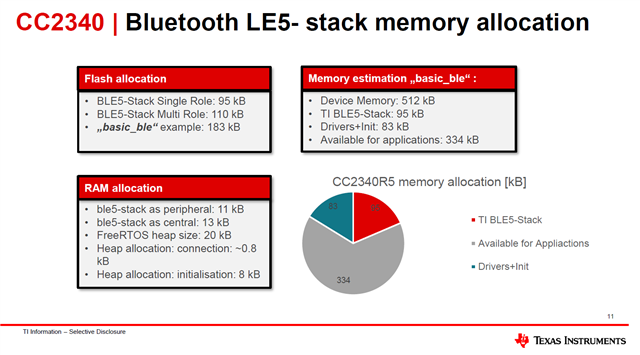

My customer is plan to use CC2340R52 to develop medical application.
And they want to know about if memory allocation of SDK9.11.00.18 will be better than before.
Please help to check :

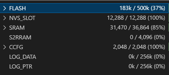

For the available flash memory for applicaiton at basic_ble(Single Role, Peripheral),  will it larger than 334KB?

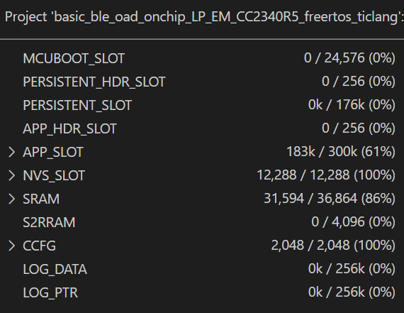

If  they have on-chip OAD, and integrate basic_ble, how much is the available flash memory for applicaiton ?
The following is the slide we got before:
