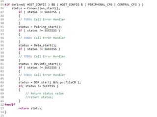

We are using the CC2340R5 part number its consumes 20KB for heap area in RAM. If we reduce the heap Memory it's advertise but, its not paring with any mobile. we configured in peripheral + observer role.
Same application is working the CC2640R2 without any issue. kindly explain what are the difference between memory of both part numbers. and how could I use the Peripheral + central  role in CC2340R5.

    We are using SimpleLink Low Power F3 SDK (7.20) SDK and we use Data Stream example code is our base code. We have modified some configurations for the multi role (Pheripheral + Central) and UART. Also we enabled Timer. We configured heap size as #define configTOTAL_HEAP_SIZE ((size_t)(0x5000)). It will work as expected like Advertising, Connection, Pairing and Communicating as expected. We need to add more modules in our applications like ANCS and TPMS. After Adding these modules we face failure in the Memory allocation.
    Then we have reduced the heap size #define configTOTAL_HEAP_SIZE ((size_t)(0x4000)). But the device does not Advertising. Is 20K heap is required for this application? or is there any other possible ways to optimize the memory?

    I attached the Ancs_CCCDConfig function for your reference. This function is called from AMS + ANCS both. Please confirm the memory allocation and free is correct we are using in this function. Is there any other function instead Ancs_CCCDConfig please let us know.
    Brindha K
  • Hi Brindha,
    At a glance, it looks okay to me with regards to memory allocation and freeing. Instead of using GATT_WriteCharValue, could you try using GATT_WriteNoRsp() instead? In some of our sample projects, we use that instead when modifying the CCCD. Something like this:
    Jan
  • Hi Jan
    I have tried the GATT_WriteNoRsp with the modifications in CCCD as you said. But the issue is not resolved still the ICall_abort happens.
    I attached Image for your reference.
    Brindha K
  • Hi Brindha,
    Understood, lets try to dig into why the icall_abort may be happening. Can you provide me with the value of ErrorNo variable when the abort is reached?
