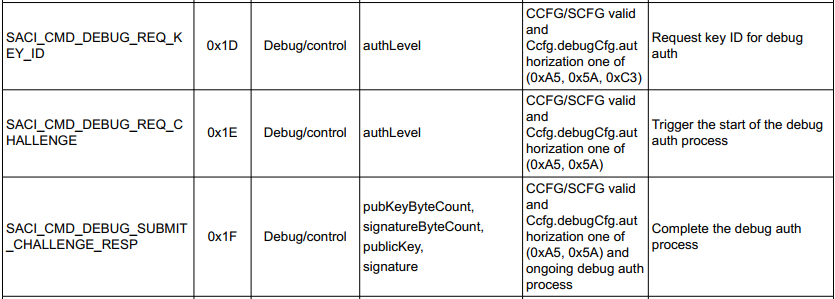

I'm working on CC2745R10-Q via SWD with my Host device
we want to implement debug authentication. As per TRM, the below commands are used for debug authentication.
and in CCS(V20.3.1.5__1.9.1 ), the debug configuration is done,and generated the SCFG.bin file as shown below

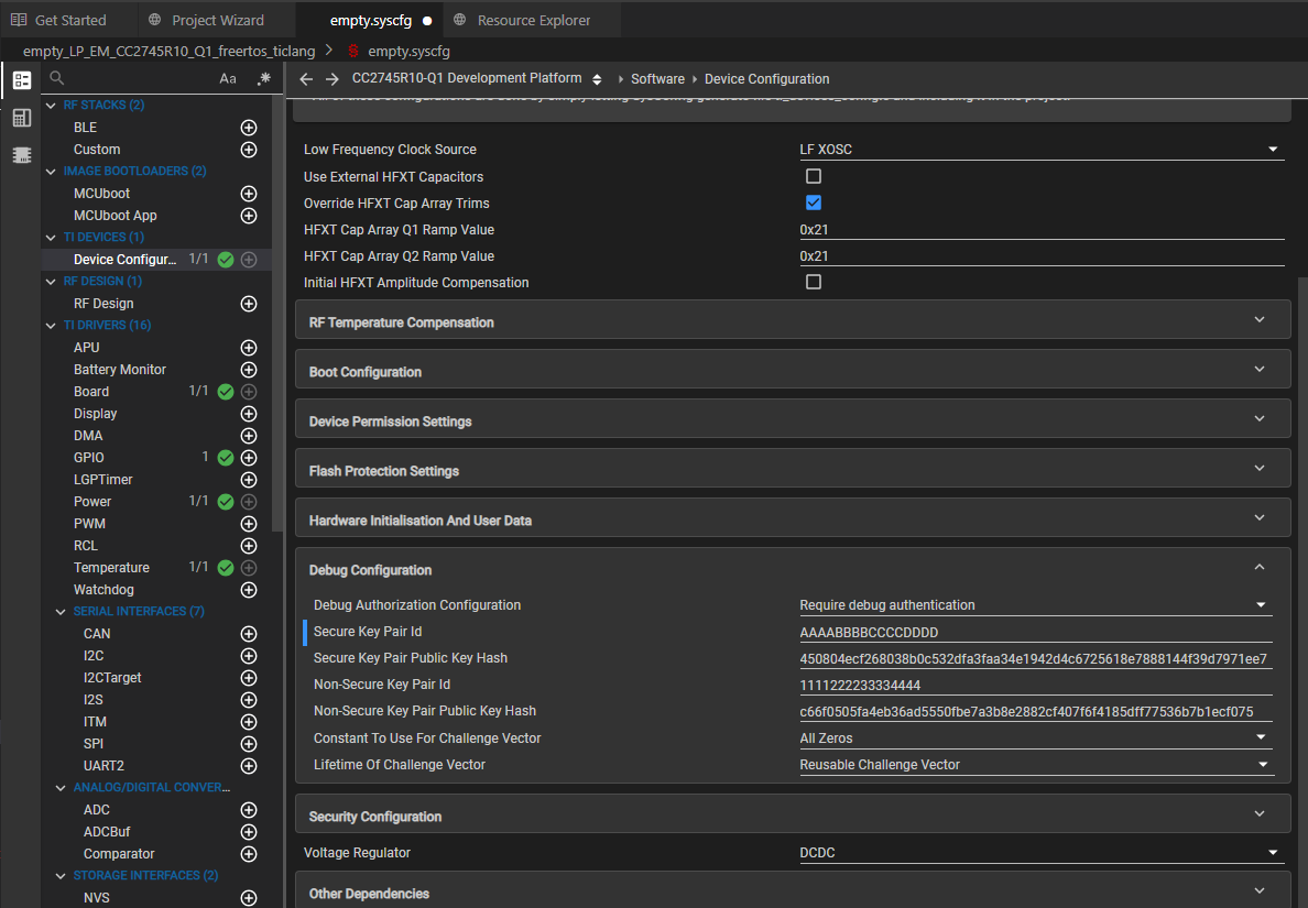

    2. As you did above, go to the Debug Configuration section of sysconfig and set the parameters you want

    2.Configured the Debug configuration as shown below, the provided the public key hash (32 bytes) of non-secure/secure is generated from the public_key.der(certutil -hashfile public_key.der SHA256)

  • Hello Surender,
    Thank you for sharing this information, I was able to reproduce your environment and successfully test debugging authentication on my end. Here are the exact steps I followed. I did however use a slightly newer SDK, the 9.14.00.39 since that is the most recent public SDK we have. However, the CCS and Sysconfig version are the exact same so it should work the same:
    1.  Generate public/private keys in DER format using openSSL. You can call these commands from which ever directory you want to save your keys.
    2. Once you generate the hash, you will copy/paste that directly into the Debug Configuration section of sysconfg. I have provided a picture of my sysconfg with the key I generated from openSSL
    3. Rebuild and flash the project (I used Uniflash instead of CCS to flash). You might see an error or some message about debugging permissions, but it should show load successful at the bottom so you can ignore the error messages since it will still work. We are still in the process of updating both CCS and Sysconfg to handle debug authentication so that is why they might appear.

  • Hello Surender,
    Right under the Debug Configuration dropdown, there is another dropdown field called Security Configuration. Please try selecting "Signature" for the Authentication Algorithm and then selecting the ECDSA algorithm you want for authentication. This should enable the use of ECC for secure debug manager. Once ECDSA is selected, please return to the Debug Configuration dropdown and then follow the same steps as before for generating ECC keys for secure debug authentication.
