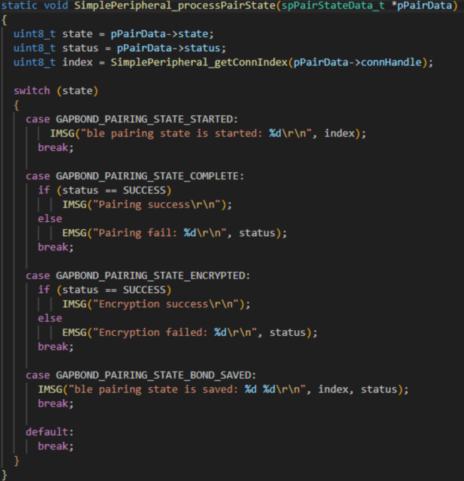

The following is the program source code

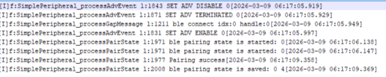

This is the paired log
